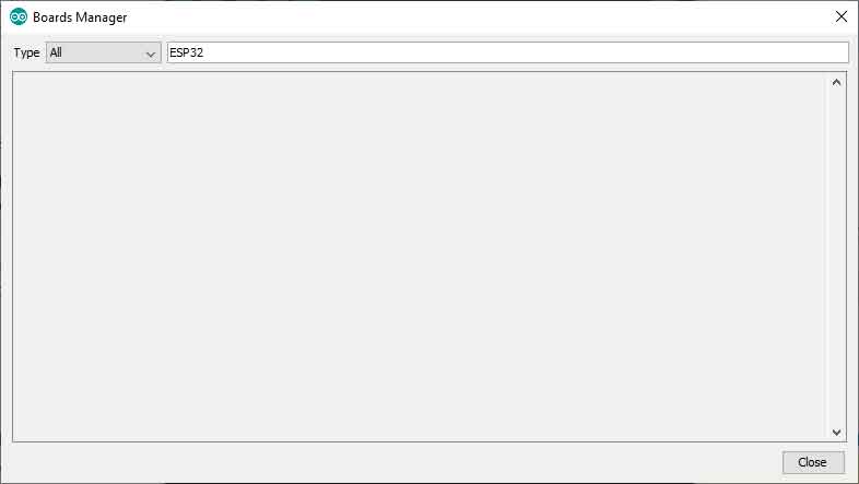

thanks for your help, if i searching for esp32 there is nothing that i can install.
esp32

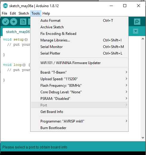

and the Port is grey, so i can´t select it
port

Its to be expected that the Boards Manager is blank.
ESP32 is not an ‘Arduino’ and to add support for it in the Arduino IDE you need to vist the Expressif support page and follow the instructions;
https://github.com/espressif/arduino-esp32/blob/master/docs/arduino-ide/boards_manager.md
Ok, i have installed the ESP32 Board have Selected the T-Beam Board but i can´t select the Port its greyed out.
If i connect the TTGo T-Beam via USB to my Computer nothing happens, so should i install some drivers? Or have to press a Button on the Board? Can´t find some Devices in the Hardware Manager. I have the Board V1 with 3 buttons.

Look at the computer system configuration and see if you have a com port for the esp device. Most of the time you’re missing the driver for the com chip on the board and you get ? Driver not present.
I can’t give you screenshots, I’m on a Mac but I had to install a specific driver as well.
