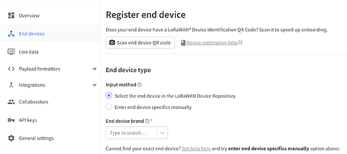

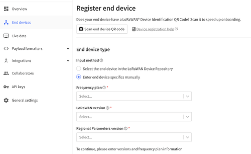

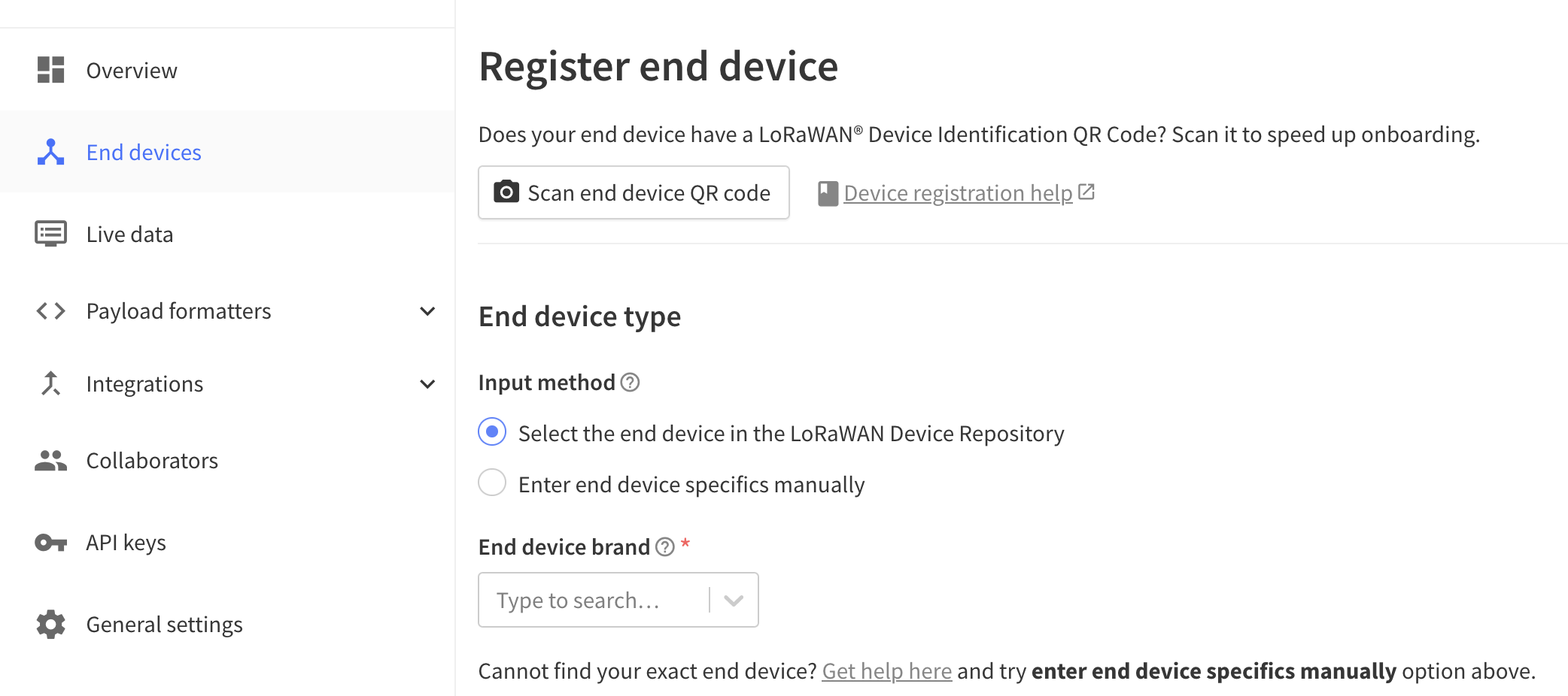

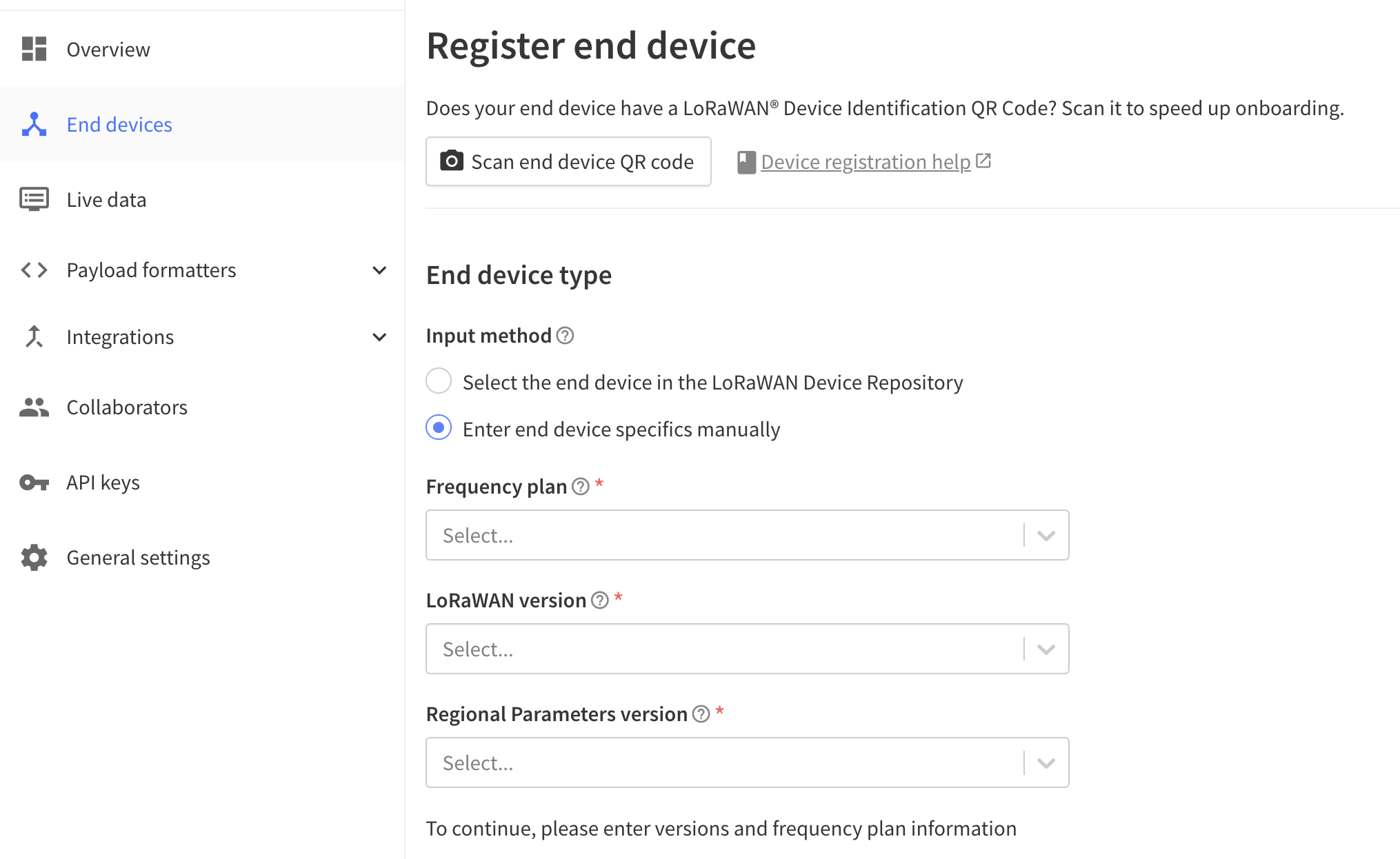

Trying to register a T-Beam v1 in my new application, and it’s not available in the list of devices. All I see is what’s in the images. I’ve searched for every string I can think of, can’t find it in the list.
How does one register a T-Beam and get the required Keys and IDs?
I don’t have any of this information:

Then use the frequency plan for your location, LoRaWAN version 1.0.2, regional parameters 1.0.2B, JoinEUI al zeros and have TTN generate the DevEUI and AppKey for you.
