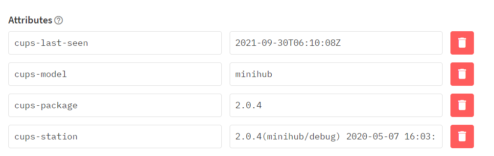

I’ve investigated further. I’m more and more convinced that the problem comes from the connection to the CUPS server. According to the console, one of the gateway has the “cups - last - seen” date set to 2021-09-30 when all my other ttigs have the current date displayed here. However, this gateway IS currenlty connected to the LNS server and correctly relays messages.
So I really think the problem comes from the expiration of the CUPS credentials that cannot be renewed for some reason.
