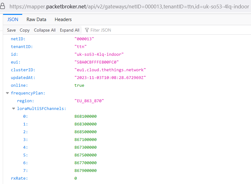

Okay, I’ve now deleted and claimed it (had to use a different GWID, now uk-so53-4lq-indoor), and it’s still stuck on rapidly flashing green - how long would that usually last? It’s been 5 minutes, but I’m wondering whether I should wait 24h or more.
power cycling usually forces it to rejoin local wifi then look at the CUPS server and update config…give it a try otherwise usually a couple of hours up to 24hrs…
Looks to be online in TTN systems :slight_smile:
Thanks. I was checking the settings, and it didn’t have a frequency plan selected, nor a “schedule any time delay”, and now they’re set it connected immediately!
As above :slight_smile: :+1: UK Community network grows by one…

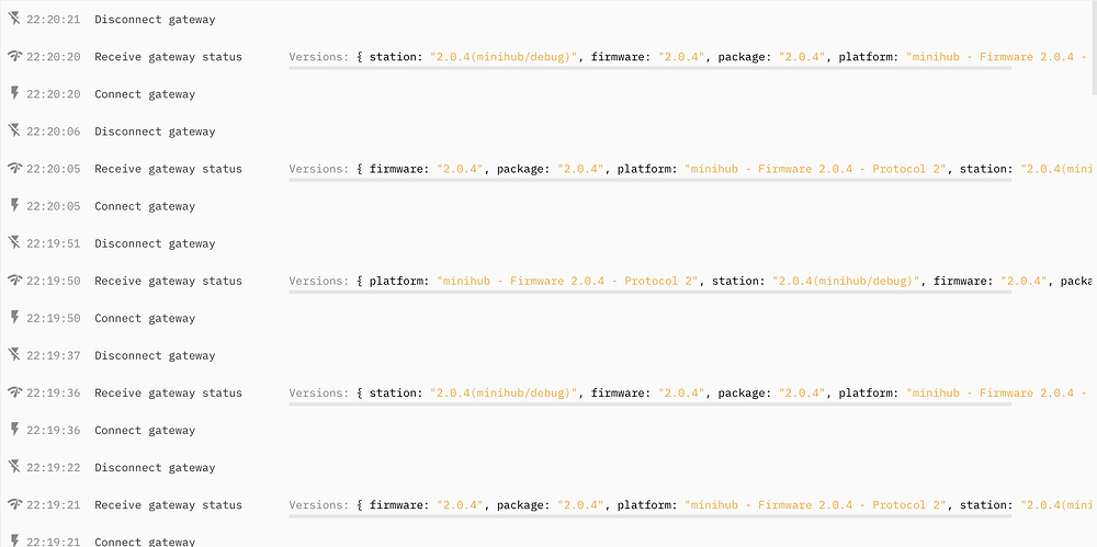

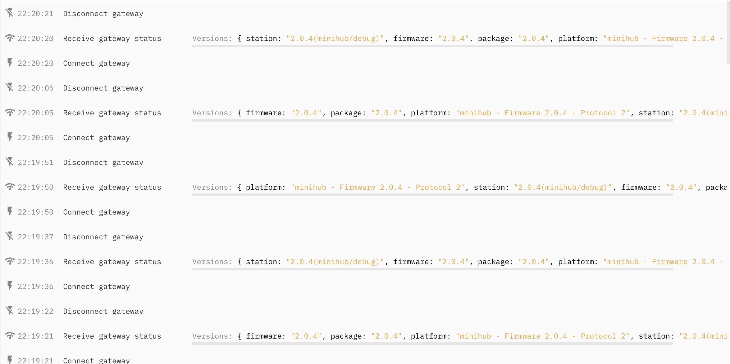

Hi everyone,
Trying to setup my TTIG. I have it connected to wifi and claimed however the Live data logs just show a constant connect disconnect loop.
58A0CBFFFE80690F
What is the GW-ID? (vs GW EUI)
eui-58a0cbfffe80690f-1
edit: my bad, I had the wrong Frequency plan selected. Selected the correct Frequency plan and all seems OK now.
