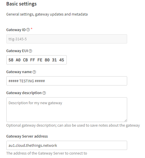

My name is Paulo and I am a rookie with lora yet. Maybe some of you already discussed the problem I’m gonna describe in the following lines and whether the answer is yes, guide me to the right topic please.
I have a TTIG that does not connect to wifi. The wifi (I think) is not the problem because I have others connected to the same router/network.
I’ve tried claming it about 4-5 times and the green led doens’t change its behavior of trying to connect to wifi.
