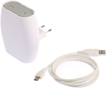

TTIG - The Things Indoor GW - a low cost Wifi only connected GW USB C powered or a Mains Power Shoe. This started life as the TABS GW developed by Tracknet and Gemtek TW under Tracknet.io - subsequently absobed back into Semtech (The Tracknet team was a spin out of former Semtech & IBM staffers). Early versions (still TABS branded) were given away at the original TTN Conf Jan 2019 and available to by from around the March/April- now sold via RS Components and the Electrcomponents Group with others also selling

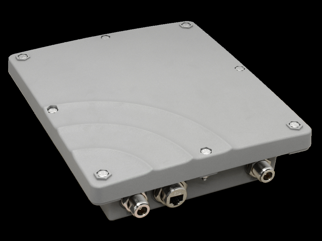

TTOG - The Things Outdoor GW - originally announced at same event as the TTIG but coming to market many months later - designed/housed for outdoor IP protection rated deployments. Typically sold via specialist disties or system integrators.
I’ve just purchased one of these to use with my chirpstack server. While I understand retailers might not update their marketing information, I see no reason why this page has not been updated:
https://www.thethingsnetwork.org/marketplace/product/the-things-indoor-gateway
I emailed the things industries about this and they have said
You can connect the gateway to any LNS that supports Basics Station protocol. You can find more on this here - https://doc.sm.tc/station/.
I’ve admittedly not read everything about Basic Station yet - there seems to be a hell of a lot to it - but I guess this means I either need to start by configuring what CUPS server the GW points at, or I need to reconfigure the CUPS server itself. I’m a bit lost as to how to start because the GW web interface is so limited.
Has anyone done this yet?
