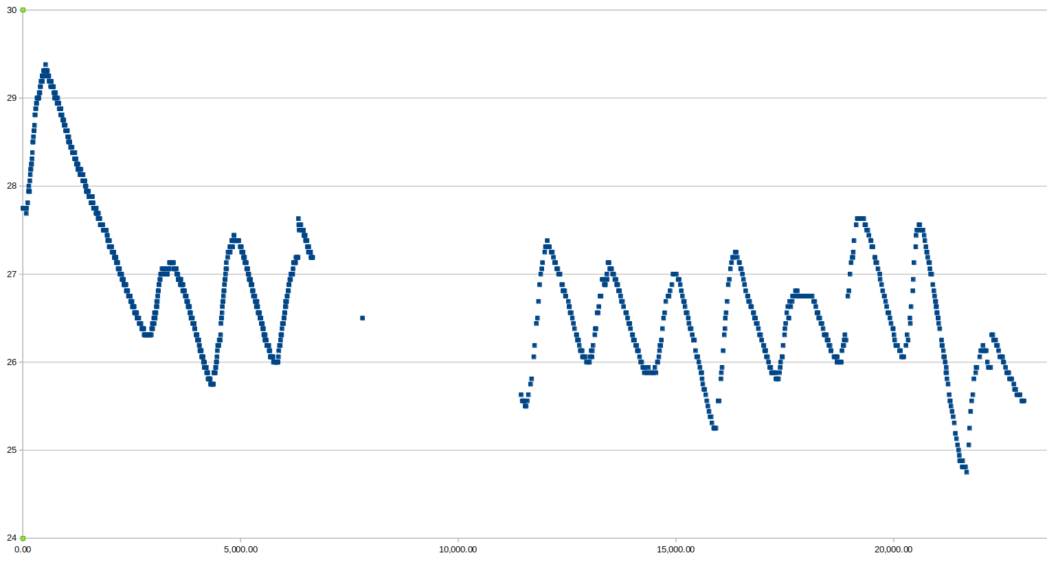

My TTIG gateway has been decidedly less effective at forwarding packets to TTN since “the event” in this post (outage from 7/26 - 7/29). I’ve calculated the number of missing reports from one device that reports once every ten minutes and plotted the number of missing reports over time from 7/21 - 8/6, and here’s what it looks like (minutes from start along x-axis):
My endpoint tries to report on a regular 10 minute interval (actually more like 8.2 minutes). The x-axis is minutes from the start of the data. A missing report is implied by the time since last report (i.e. ROUND(deltaT / 8.2) - 1). There’s a pretty obvious increase in the incidence and duration of missing events. Here are histograms of the missing reports before and after the event.

Here’s what it looks like as a manifestation in my data. You can see the difference in the time-density of data points before and after the 3-day gap.
