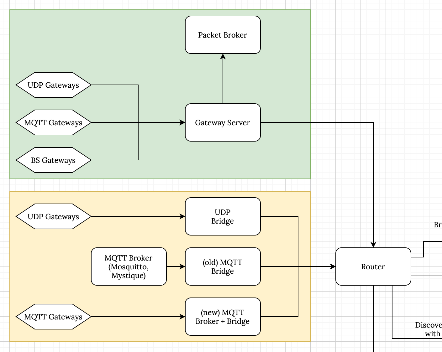

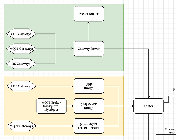

The last “documentation” I know of is found in an unrelated issue on GitHub. Overview of April 3rd:
Since our community network clusters all look different, and things are changing all the time, it would cost us too much time to maintain an up-to-date overview of how things are connected in each region.
In the image below you’ll see how gateways can connect to a v2 network. The old situation (yellow) will slowly be migrated to the new situation (green). We do this by first routing a small percentage of traffic for a given gateway protocol through the new components, and slowly increasing that percentage. The same for the other gateway protocols.
bridging
As @johan mentioned during his presentation at the conference, many community network gateways already connect through a v3 gateway server, and we are slowly connecting more gateways through v3 Gateway Servers over time.
Apart from these Gateway Servers the entire Public Community Network still runs v2 components.
