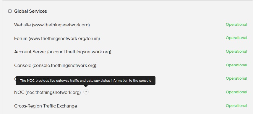

The TTN server seems to be updated right now, all gateways are listed as offline in this moment. Maybe that’s the reason you can not find it.

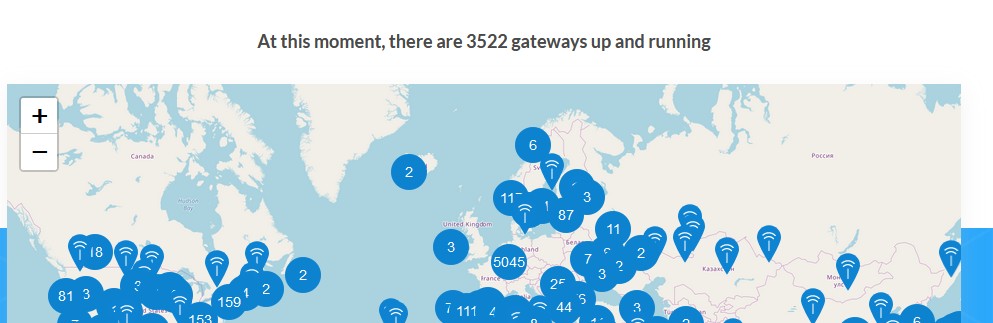

yes we are missing a few GW’s
but not here
I meant strange SNR; I have two red gateways on TTNmapper (not TTIG) but they are running fine.
