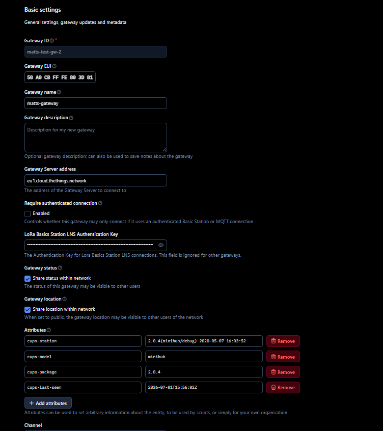

I am experiencing a persistent “60-second connection loop” with my The Things Indoor Gateway (TTIG). The gateway is currently showing a “Yellow” status in my console, and I have verified that it is trapped in a loop where it successfully completes the TLS handshake with the CUPS redirector (52.59.202.240), but fails to receive an LNS cluster assignment, leading to a clean FIN disconnect exactly 60 seconds later.
Diagnostics performed:
  • Factory Reset: Performed a full hard reset (held button until rapid LED flash) to clear local NVRAM/TLS cache.
  • Network Path: Confirmed the gateway has a valid IP via DHCP, and DNS resolution for rjs.sm.tc is working correctly.
  • Console Settings: Verified frequency plan is correct (Europe 863-870 MHz) and “Require authenticated connection” is disabled.
  • ISP Change: This issue began immediately following a change in my ISP/network environment.

I suspect this EUI might be orphaned or flagged in the global registrar following my network change. Since this is a hardware-locked TTIG, I have no way to manually re-provision the LNS tokens.
Could an admin please check if EUI 58A0CBFE803D81 is correctly mapped to my account’s eu1 cluster, or if it is stuck in a stale state that requires a backend “reset”?
