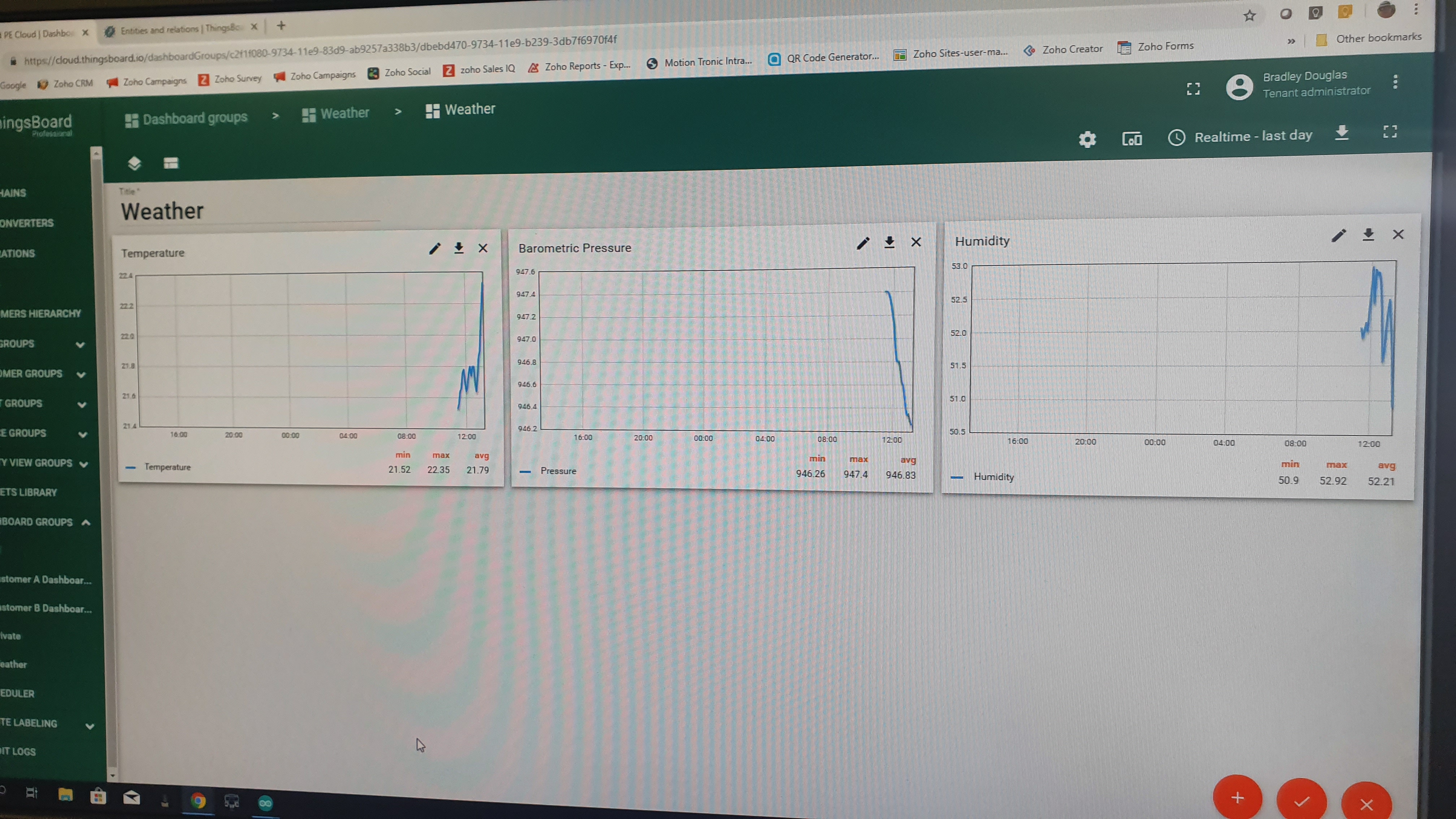

I would suggest Thingsboard, with it multi-tenant feature… although integration with TTN is not easy in the community edition (very easy in the professional edition)
Right so thingsboard seems amazing with options , takes a little getting use to but plenty functions to suite most needs.

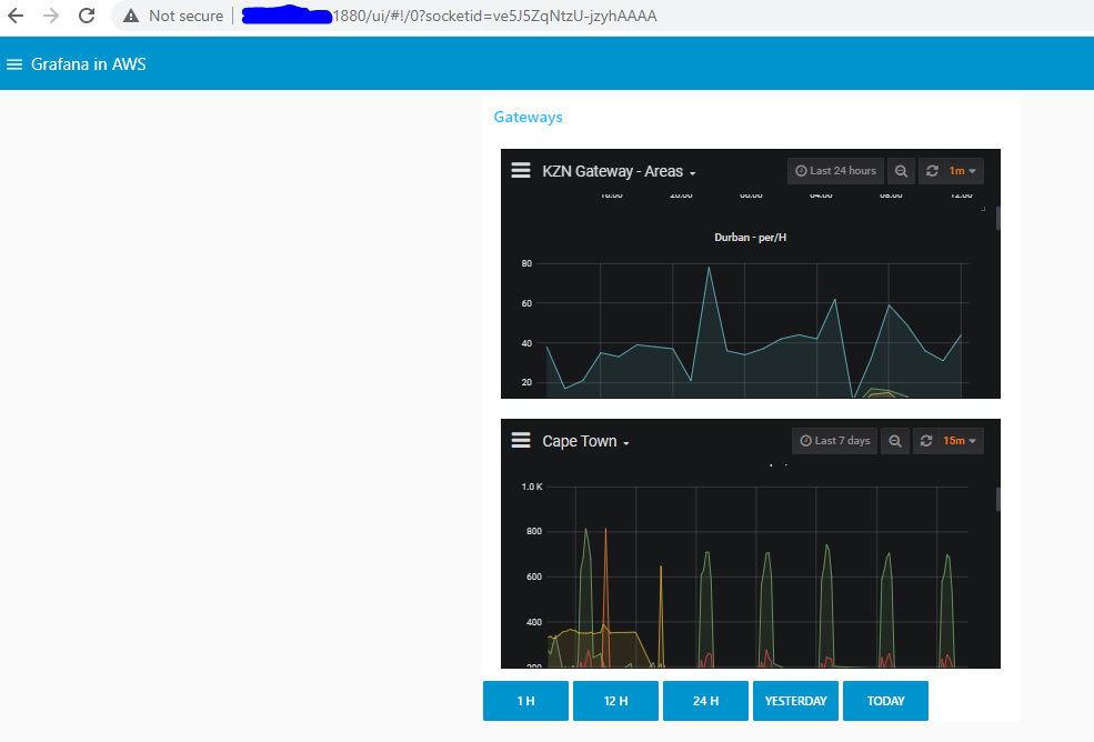

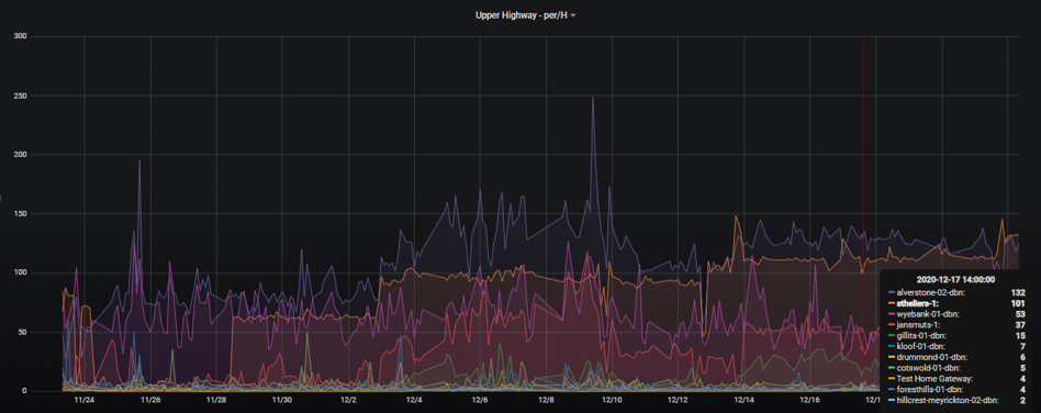

I have been using a combination of Node RED, InfluxDB and Grafana just by watching some tutorials on youtube.

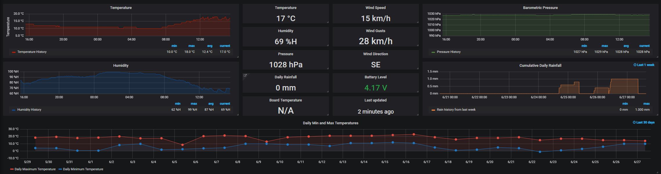

I see you are doing weather - have a look at my weather dashboard developed in Grafana.
Grafana offers a lot of flexibility, is open source and has a great community around it.
