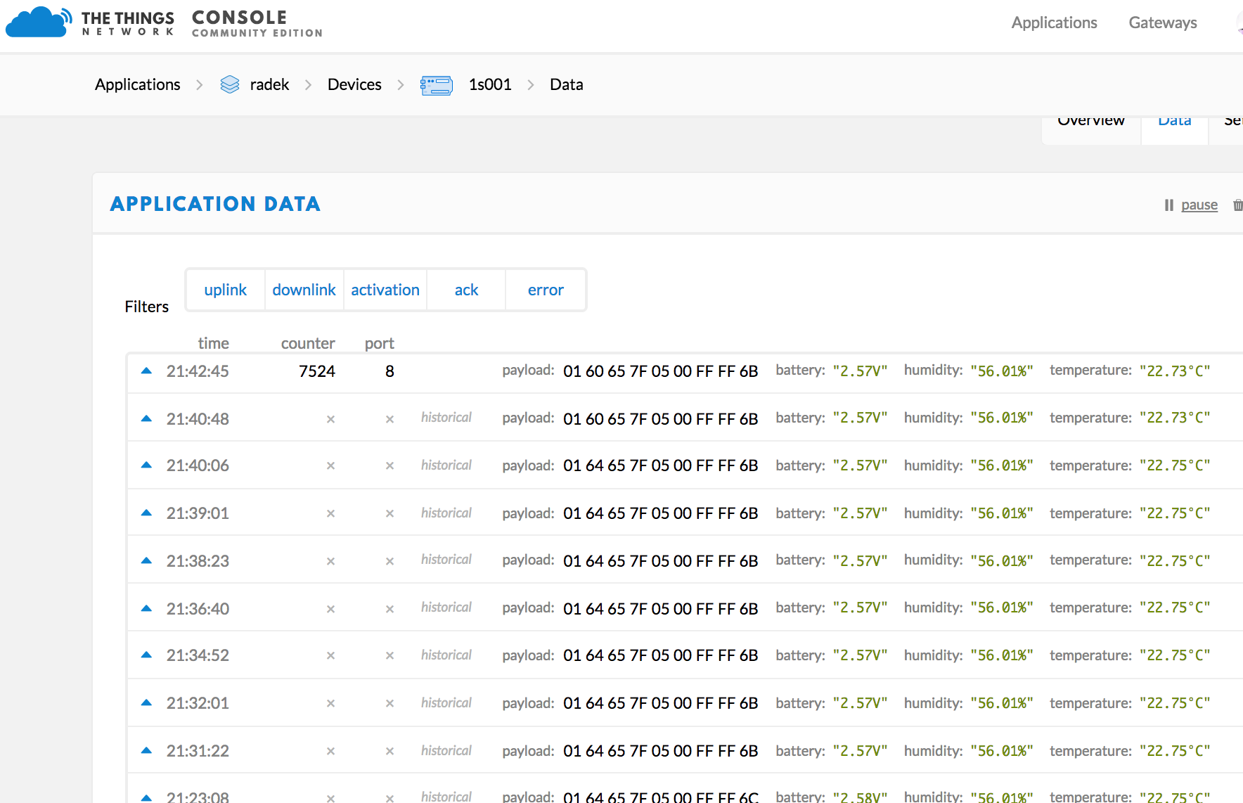

(Wdesan) #3
With real data!!!

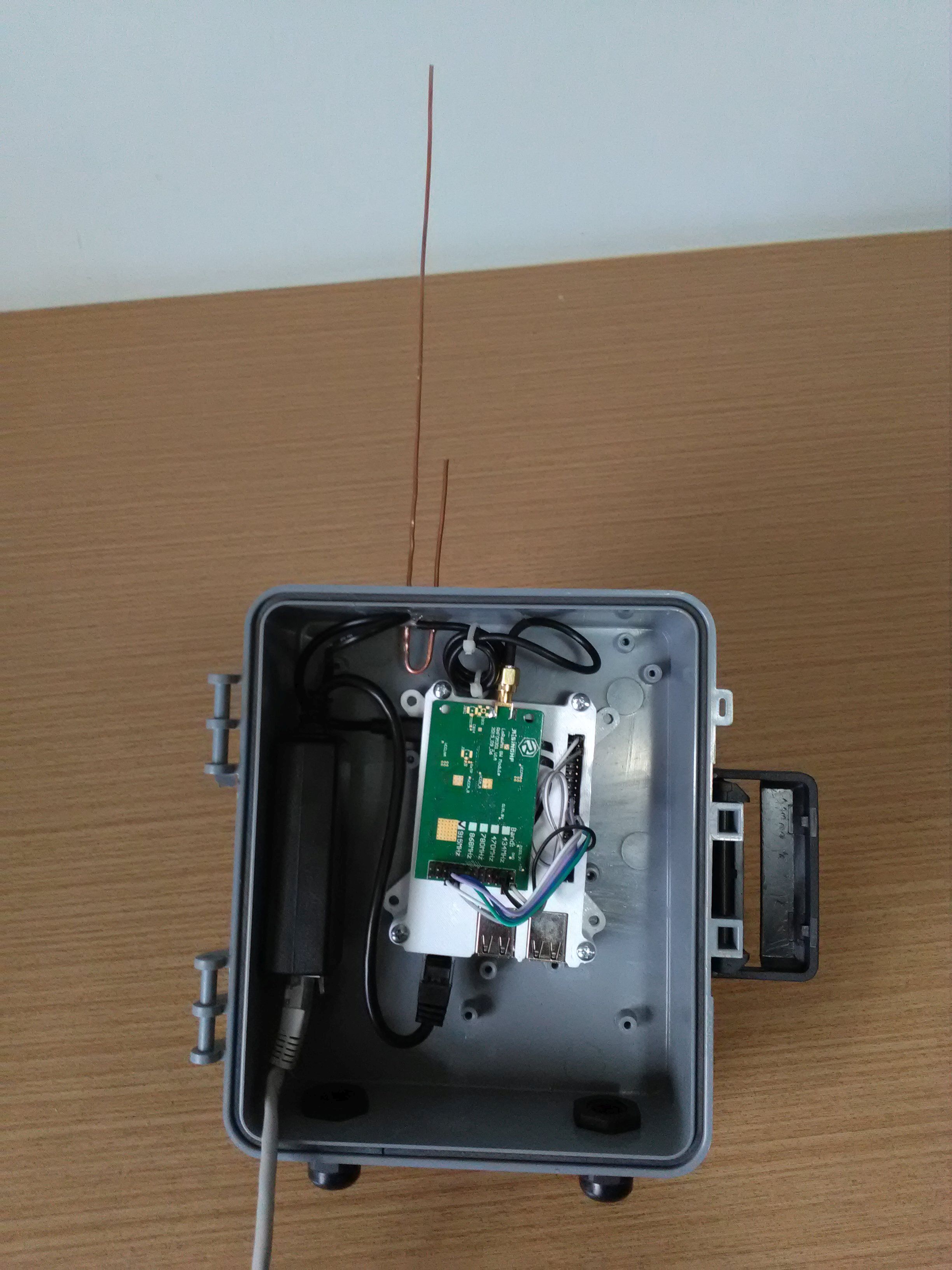

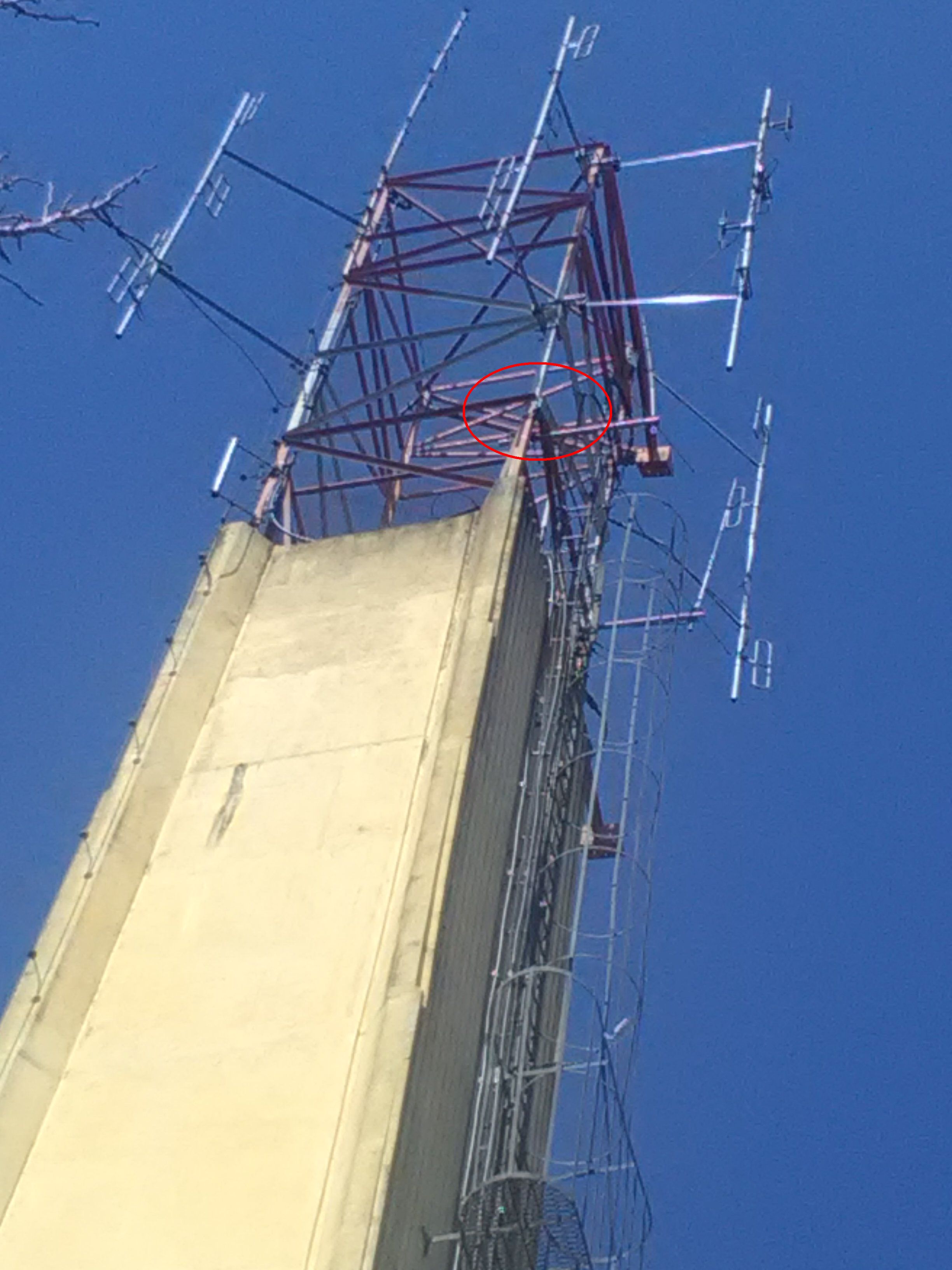

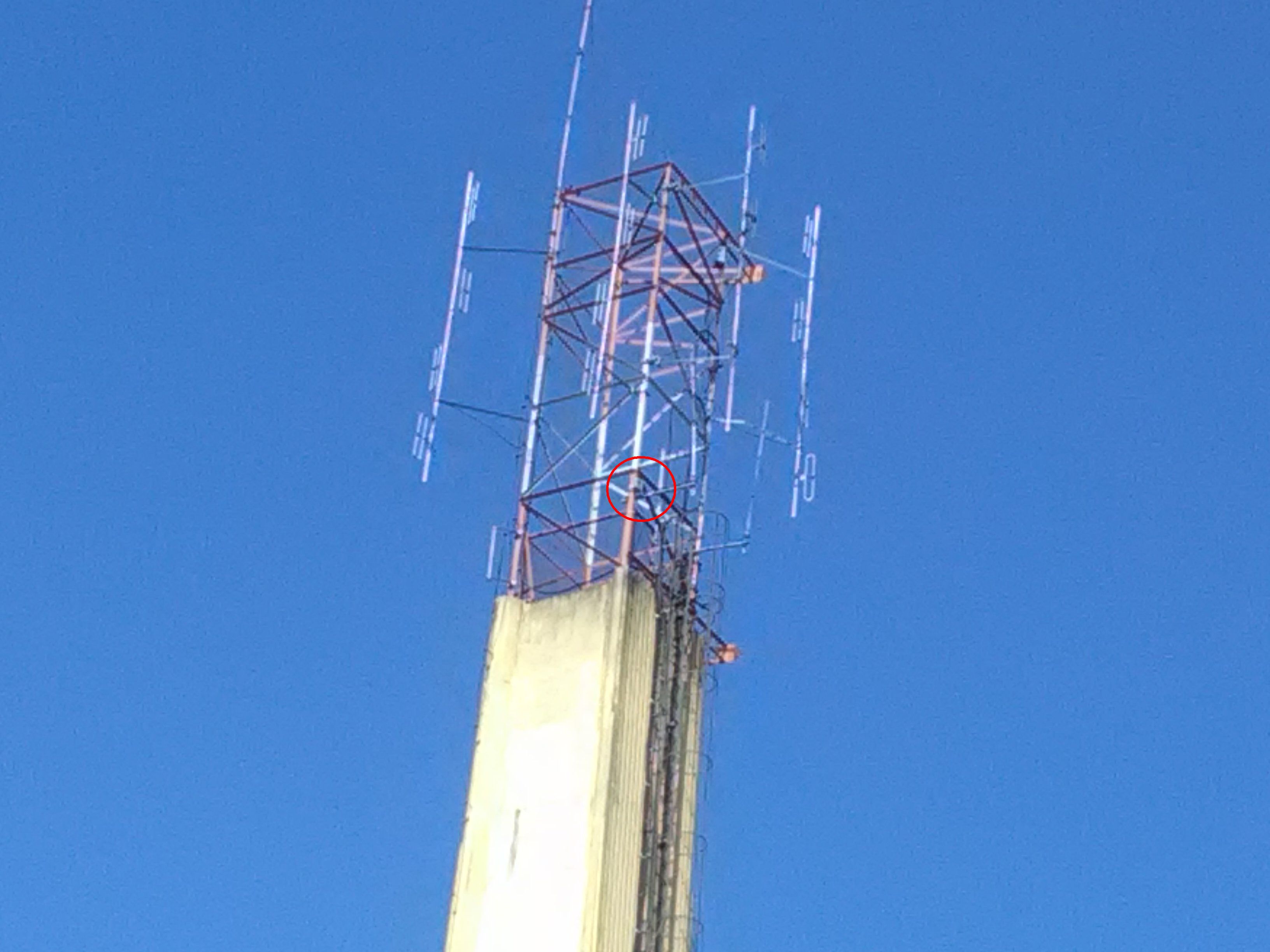

Last monday we mounted the DYI gateway on the tower . To get power on it, we installed a PoE adapter to the Raspberry PI. The antenna is a simple copper wire J-pole. The pictures are below.
In the initial tests the signal reached 2.42 km NLOS, with a little 1/4 wave antenna.

Hi Marcio! I see you connected your RPi to the LoRa gateway with jumpers instead of with an adapter board. Has it worked ininterruptedly since you installed it? Are you using a POE as a power supply?
(Marciolm) #8
Hello Thayuriko,
Yes, I connected the RPi using jumper wires and (fortunately) it is working flawlessly since the installation. I know, it’s not the best thing to do, but I don’t have the adapter board.
I found the PoE kit (injector + splitter) for RPi on Aliexpress for about US$ 13.
