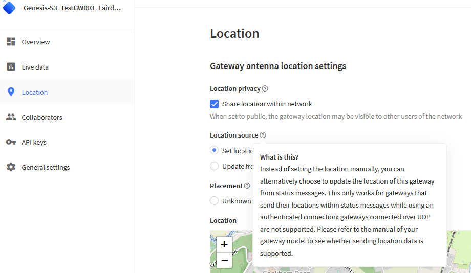

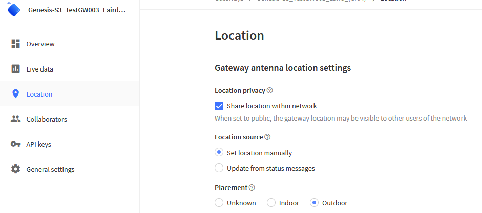

On the GW Console page under the Location Tab there is option for location source…most set manually directly in the console but there is an option to update from source status message - read the little ? for information - UDP based GW’s not supported…
Thanks for the info and sorry for that I had not noticed the little mention about fact gw has to be connected in authentified mode with TTN server to get GPS data used by TTN. I have switched my RAK7289 from packet forwarder to authentified mode with API key and TLS certificate ! Gateway is still working for LORA downloink/uplinks but it’s not taking into account GPS data of gw :frowning: I’m not sure how gw is supposed to send GPS data in this mode as it just sent a sort of registration message at beging but that’s it !
If you are using LoRa Basics Station, it does not support GPS data.
oki so basically it’s impossible to send GPS data at TTN to update properly gw coordinates ? My Rakwireless gw has only the packet forwarder or Basics Station mode ! Are there some other modes ?
