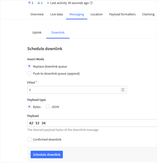

here is a snapshot for downlink message
and here is the result in Serial console after cick on Schedule downlink
-- MESSAGE
Received 3 bytes RSSI=-44db a2 12 34

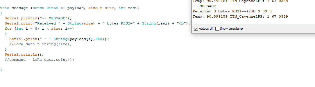

I just tried to do the same and received this in my serial monitor.
-- MESSAGE
Received 3 bytes RSSI=-42db 3 33 0
void message (const uint8_t* payload, size_t size, int rssi)
  Serial.println("-- MESSAGE");
  Serial.print("Received " + String(size) + " bytes RSSI=" + String(rssi) + "db");
  for (int i = 0; i < size; i++)
    Serial.print(" " + String(payload[i],HEX));
  Serial.println();

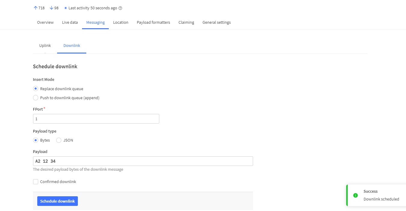

down1
down2
May I see your full sketch? How did you get the same thing you sent down? I tried to replicate your code but I’m not getting a2 12 34
