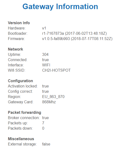

Hi all
The new version of the firmware 1.0.5 has been pushed to beta. It fixes the failing LoRa module issue which resulted in an unexpected reboot. There was a variation between the module and the gateway board which created the time related problem. All gateways that have automatic updates on will be upgraded to this version.

And looks like got a gateway revival
Anyway, note that SD card with FAT works also, worth mentioning the doc not only FAT32, because you can temporarily use a Raspberry PI SD card and put the 2 files on boot partition (in a folder named update), works like a charm, once updated (gateway up with new firmware), shut down the GW, remove SD card and put back where it comes from and restart your GW
