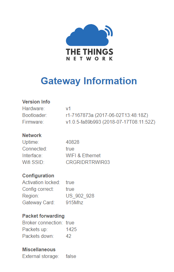

(The Things Products Team) #308
Hi all
After testing the beta firmware 1.0.5 version last week, many gateways have seen significant improvement in their overall stability due to improvements in communication with the LoRa module. This morning we pushed this version to the stable branch and are seeing the gateways getting updated around the world. As mentioned earlier, this update addresses the LoRa module issue which was causing the reboots and one of the main reason for gateways working properly. Next on the to-do list is WiFi/MQTT stability along with updating the harmony version. In case the firmware is not getting updated on your gateway, you can install it via SD card or a programmer, see instructions here.
Will keep you all posted on further developments next week.

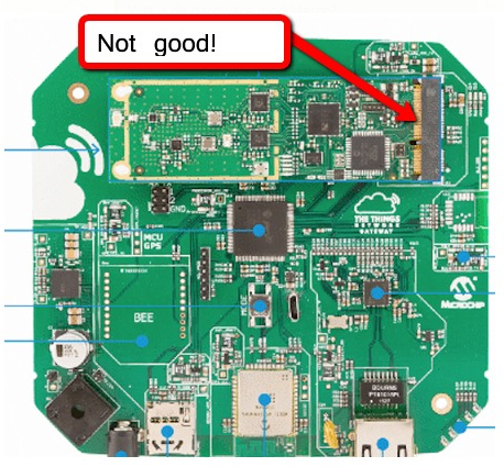

#310
Have you checked this connection
#311
Yes, that daughterboard connector seems to be a real problem. One of my gateways wouldn’t boot properly, and thus couldn’t update firmware, until I reseated the daughterboard. I’ll hopefully be able to try this on my other gateway this weekend, because it also isn’t installing the update (and been off the air for 3 months).
The big question is whether the firmware update is enough to fix the issue, or this connector problem is just going to keep coming back with time (thermal cycling, vibration, etc).
I wonder if @TTP have identified the cause of the connector problems, and if there is a suggested DIY fix? e.g. shaving off a small amount of PCB on the plug-in edge so that it seats deeper…

(Abaretta) #313
I was wondering about this as well. It does seem to be a separate issue and I haven’t seen/read about any investigation into this from the TTN team.
I just got my gateway online again and even upgraded, but not without fiddling with the daughterboard (putting pressure on it, attempting to wiggle it a bit in its socket).
It is now running v1.0.5-fa89b993, we’ll see.
(Reinier van der Lee) #314
Auto updated to Firmware v1.0.5-fa89b993 and looking good. So far > 100,000 successful uplinks and 1,200 downlinks.
#315
I managed to get my other gateway to update with just a power cycle, but it was getting UART ERROR until I reseated the daughterboard.
I didn’t have any nodes with me (Doh) so I couldn’t check uplinks, but it was (and still is) showing a connection to the backend - which it hasn’t done for months.
#316
Replying to my own message: I noted that I am on 1.05 now (did not do anything to go from the previous 1.0.4b) and the gateway seems rock solid. I cannot measure any packet loss (i.e. reboots), working via wifi, more than 10K messages sent over the past 6 weeks.:+1:
(Siso) #317
Here also since 1.05 not any unexpected reboot.
(Joost Lambregts) #318
Thank you, this was indeed the problem.
