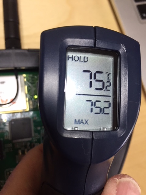

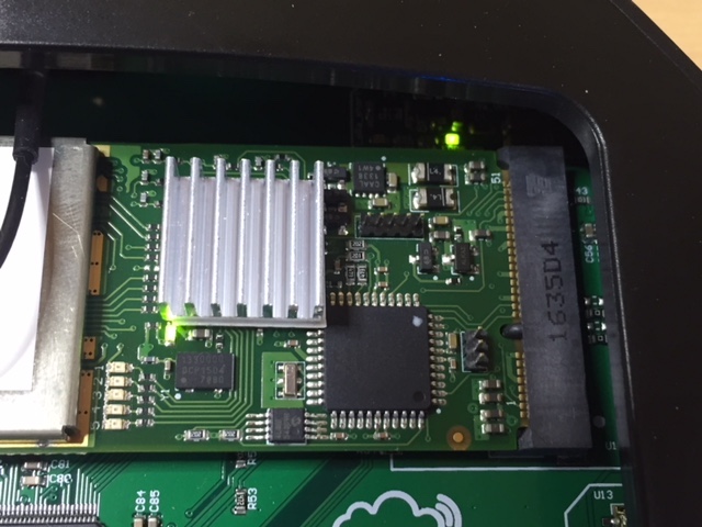

We are installing a TTN gateway outside in a waterproof cabinet. At room temperature I measure 75C on the package of the SX1301 Baseband chip. In California Summers, we can easily get over 40C, and I expect the inside cabinet temperature to be even higher. Chances are that the die temperature gets too high under these conditions. Using a small heat sink, the temperature was reduced by estim. 35C (40C measured). Recommending this mod for all installations operating under extreme heat conditions.
…and orientate black back away from sun if ā€˜housing’ in any way transparent/translucent/IR permeable (home/office/outside cabinet!) :wink: Tee Hee…
