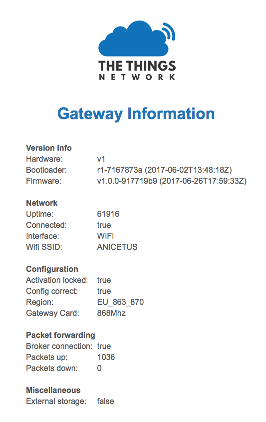

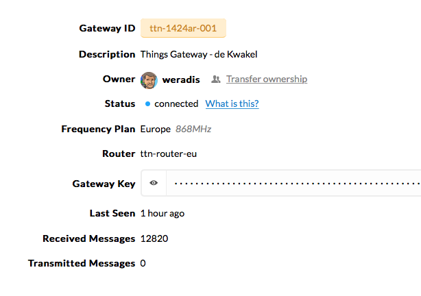

(Willem (pe1dlf)) #393
Gateway still connected although nothing received in an hour
Console shows nothing received from gateway since an hour …
20
connected doesn’t mean really connected …
