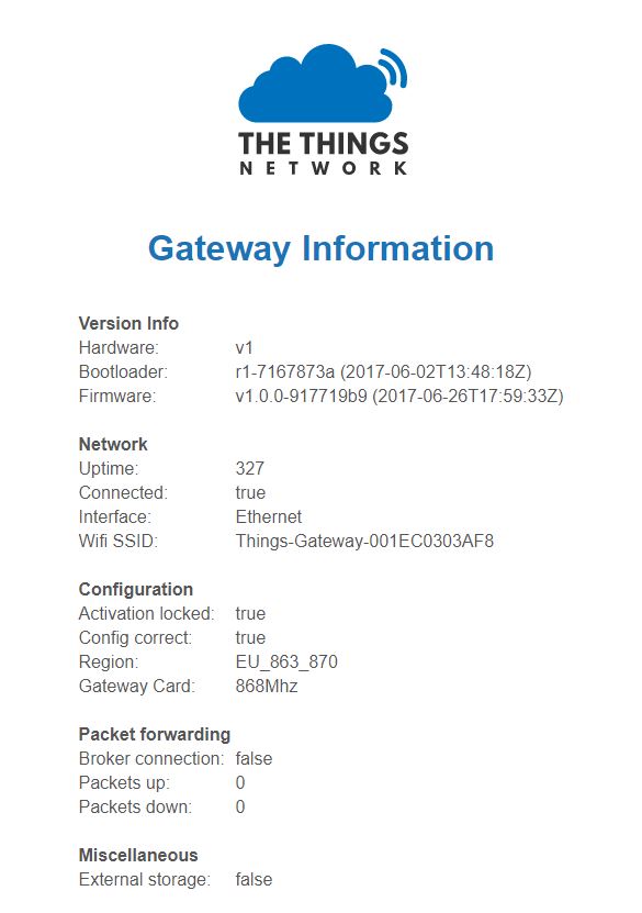

(Dolphin) #426
My gateway still not works. If I switch of the wireless network, for a short time I see : 2018_02_07-WLAN-OFF-NETKrausrein-3LEDS|351x500… then reboot. The message broker never works…

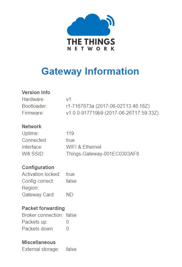

If I activate the wireless network again:
Gateway Card: ND and Config is false ???
(Dolphin) #429
If WiFi and Ethernet are available, the gateway never reboot - but also config correct is false an Gateway Card is ND. For ever! After power on and off, the reboot start again, if wireless is off! But in this case for a short time Config correct: True…etc. then reboot.
