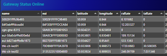

With in 3km there are actually 7 active gateways.

What frequency plan is the node set up for?
This:
