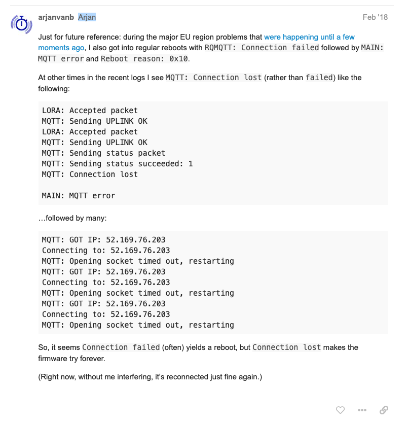

There are cases it gets stuck on - MQTT: Opening socket timed out, restarting - the only solution when that happens is to remove the power for some time.
I found this old message … looks pretty much to what I see …
Screenshot 2022-03-22 at 16.43.55
Cheers, Willem.
