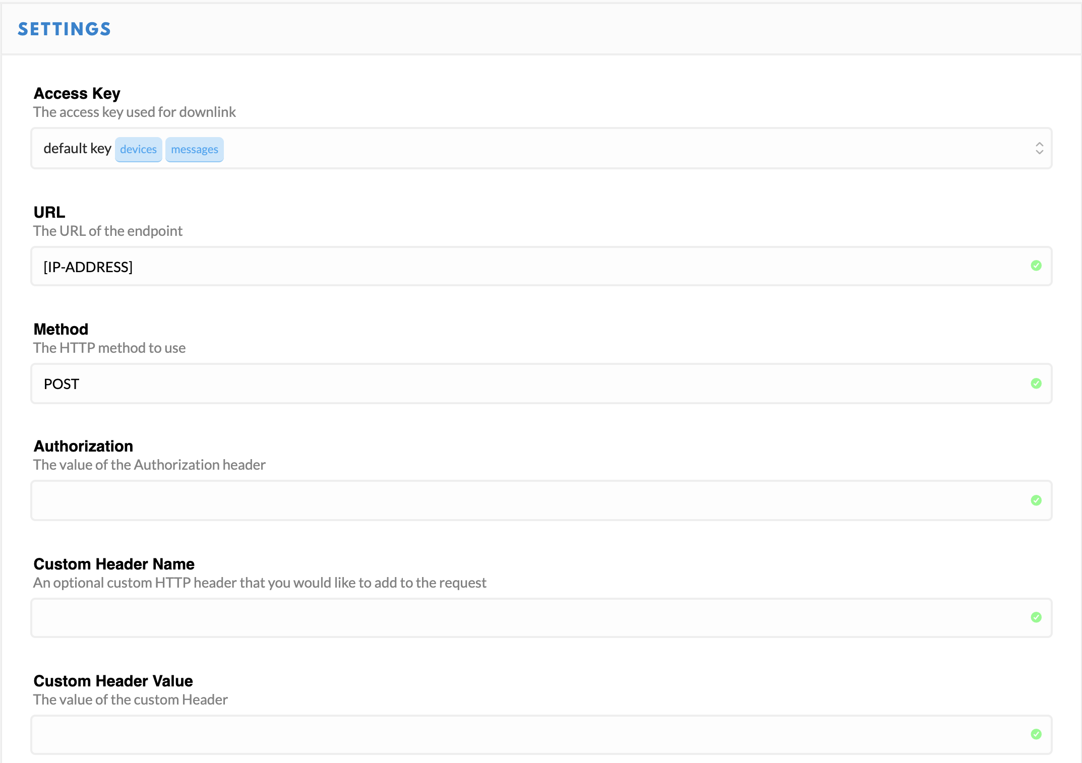

HTTP INTEGRATION
Created http integration which looks like this:
Status: Running
16
[IP-ADDRESS] --> is the ip address of our server - xxx.xxx.xxx.xxx

Hi @DTUIotLab, you appear to be mixing up the TTN HTTP and MQTT integrations.
Your TTN application integration is trying to post the uplink data using HTTP.
Your server-side code is trying to listen to the MQTT publish/subscribe system.
These are completely separate protocols for integration.
MQTT integration is enabled by default so if your python code is correct then this will work without any HTTP integration on the TTN servers.
I suggest that you start by following the TTN Quick Start at https://www.thethingsnetwork.org/docs/applications/mqtt/quick-start.html
Get MQTT up and running using the quick start and then start to work on using python.

Your code is not for HTTP integration :wink:
