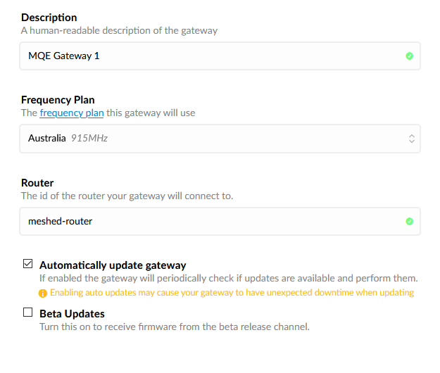

Ok then. So is it possible for you enable AU915 on my gateway eui-58a0cbfffe8031b1?
Please add your gateway to this list; TTIG AU915 support
Once we reach a certain number, I’ll batch configure them (mostly later today).
All of this is a temporary annoyance. I’m working hard on getting a self service server setup for TTIGs. More information to follow later.

It would be helpful to put that in the datasheet or on the console when you go to register the gateway. I ordered it from RS https://au.rs-online.com/web/p/communication-wireless-development-tools/2018877
and there was zero mention that it required any manual config or the AU915 support was not yet ready to go
Anyway I am looking forward to it working hopefully when I wake up in the morning.
Cheers from down under!
