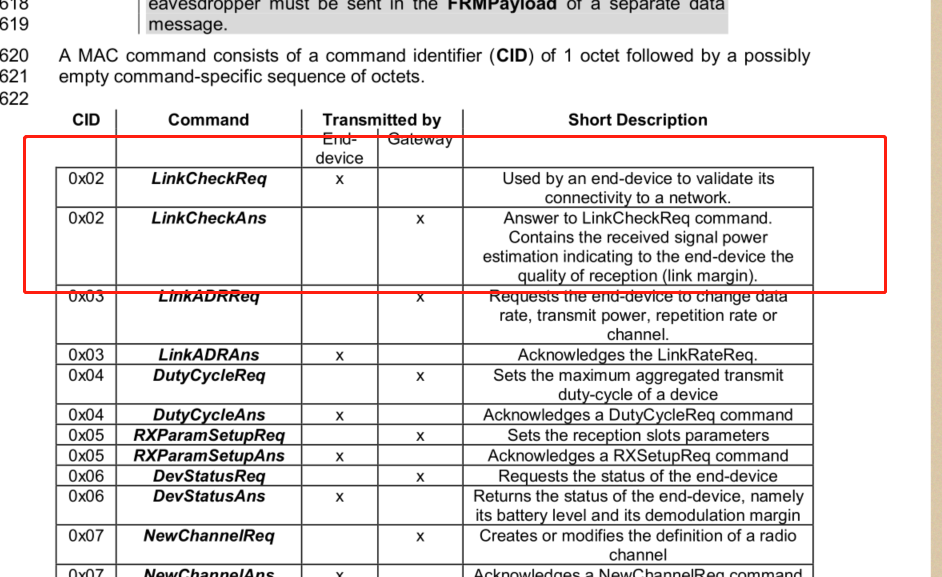

HI ,i am using my company’s devcies to test in TTN server. we develop the linkCheckreq function in our farmwire. We test linkCheck in many servers,like TTN ,senet ,RXHF. But only at TTN server ,the linkCheck seems didnot work , when we uplink the linkCheck commadn from node to server, there is no reponse command from server.The linkCheckreq command is used by an end-device to validate its
connectivity to a network, we think this is very important function for LoRaWAN application. Can someone help us to check this problem? it menas that TTN didnot support linkCheckreq or others reason.
The following is a description of linkCheckreq in LoRaWAN™ 1.0.3 Specification from LoRa Alliance:
