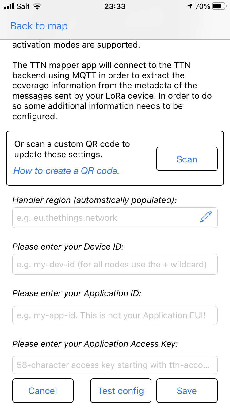

Hi guys, i need to finde the Applikation Acces Key. Where can i find this Key?
it starts with ttn-account right? Can someone send me an example(image)?

I know it has to be there but i cant find it.

Which ‘app’ are you referring to that needs an API Key that is 58 characters that is for TTN Mapper? Which website?
image Yes its for the TTN Mapper
Could it be a problem of TTN (V2) and (new) TTS (V3)?
Here an example of the (old) TTN (V2) Acces Key:
ttn-account-v2.NCGfWW_ilGKlSVk4GfoqAoN7nAimCsnO7OGT5xWnp4B

Is the app V3 capable?
I doubt it if it’s asking for a v2 key and it’s using ‘eu.thethings.network’ for the MQTT server.
If you have a device setup on v2 you can still generate keys on there at the moment - go to an application and scroll to the bottom.
