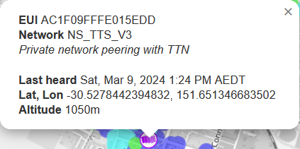

All i get when clicking on a lot of Private gateways is just the EUI and it stating " Private network peering with TTN
doesn’t show the name/description I’ve set - which is kind of critical for Australia due to AU915/AS923 coexistence (mine is only AU915 FSB2).

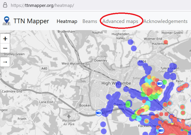

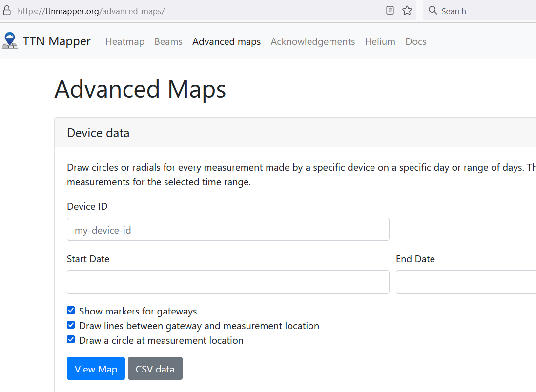

One thought did you look for your device specific data/plots under Advanced Maps?
It may be your data hasn’t been registered in main heatmap yet or is being rejected for some reason or trated as experimental (what HDOP values do you get?) or are you using with phone association?
If your data being accepted via the TTN Integration (you enabled that, right!?) this option should show ‘something’!
If there is a marker showing up for your gateway’s EUI, with some coverage, then everything is working correctly.
From TTN Mapper’s perspective, the ttnmapper.org website only shows coverage of the community network (TTN, lately called The Things Stack Sandbox). This however does include private networks that contribute coverage to TTN. But these private networks’ gateways only show the EUI, like you see in your case.
The argument is that if someone can afford a private network instance, then they should contribute financially to the mapper website too. For that reason there are a couple of suggested tiers on Patreon, see: TTN Mapper Patreon
