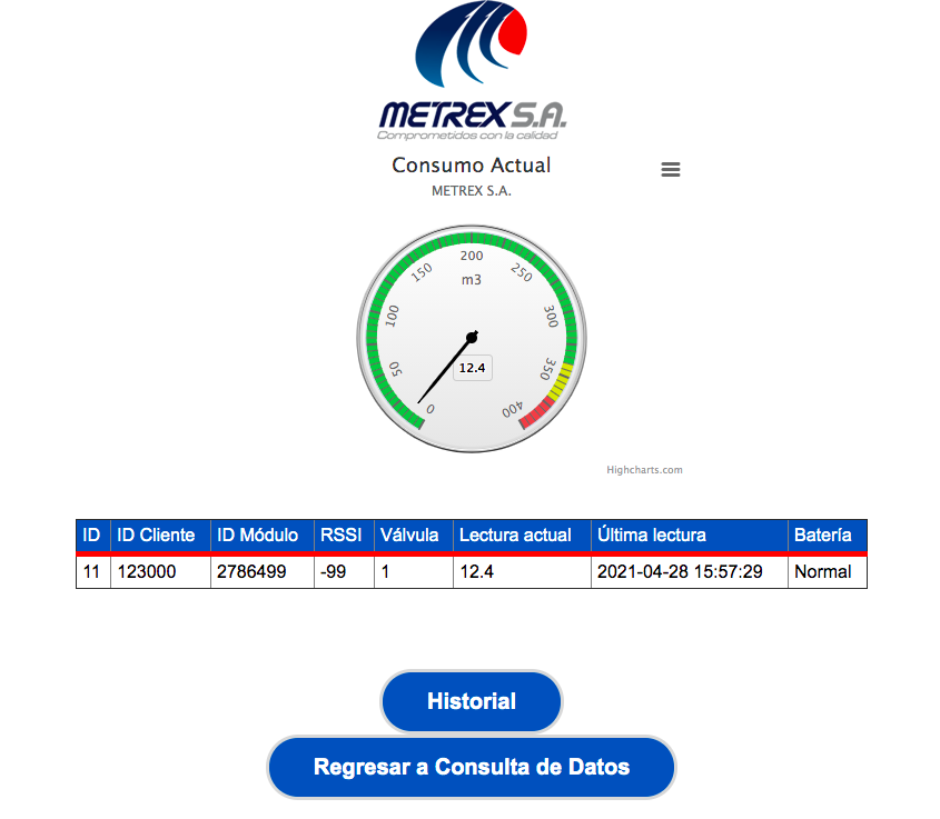

At the moment I am receiving data from a LoRaWAN node on the TTN platform (V3), my idea is to be able to store those values ​​in a MySQL database to create charts.
For this I have developed a web application based on (HTML, CCS, JAVASCRIPT, PHP …) as shown in the following image:
  • Captura de pantalla 2021-04-29 a la(s) 2.16.46 p. m.
    (Note: Image values ​​were entered manually)
I have bought in Hostinger a hosting and a domain to store my web application and the values ​​that come from TTN (V3) in MySQL databases.
I see the information flow as follows:
TTN (V3) ----> MQTT integration ----> MQTT broker mosquitto ----> MySQL ------> Web Application ---- Graphs.
