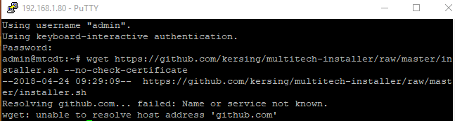

[Update] it seems like it’s another problem, I have no connection to internet with my gateway image

For your second post… The error shows that it is not able to resolve DNS. Is your gateway connected to your router using a static IP, or DHCP? Static IPs do not have DNS servers specified, so you would need to manually specify them. DHCP will set this up for you.
You have two options:
  1. Set up the network interface yourself, then download Kersing’s packet forwarder script
  2. Use something like PuTTY scp and copy the file from your computer to the Conduit, and then let Kersing’s script set up the network for you. This is the method mentioned in the instructions.

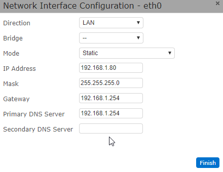

Well my gateway is directly connected to my computer with thoses parameters : image

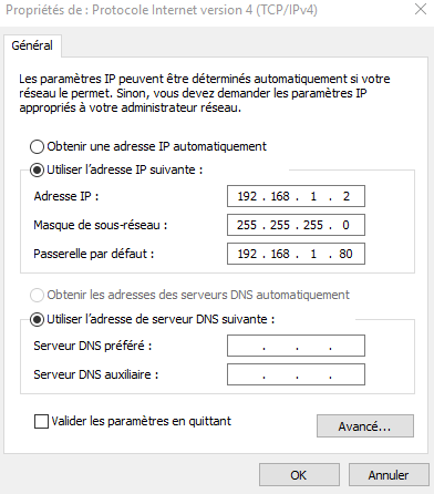

And on my computer : image

Ok, so now I know your problem. Your conduit does not have an internet connection, as it’s connected directly to your computer. A computer does not act as a router, meaning you can’t download the file from the internet.
What you should do is change the “Mode” from static to DHCP, and connect it to your router. You’ll then need to log into the router and find all the IP addresses that are connected to it - keep trying the different IPs until you find the device.
Once you change the mode to DHCP, you will not be able to connect to the Conduit using 192.168.1.80 any more. Make sure that you can log into your router and find IP addresses before you change the setting on the gateway!
If you get this wrong, the easiest method is to factory reset the conduit, and the IP address will go back to default.
Don’t forget to put your computer’s settings back to “automatic” as well!
