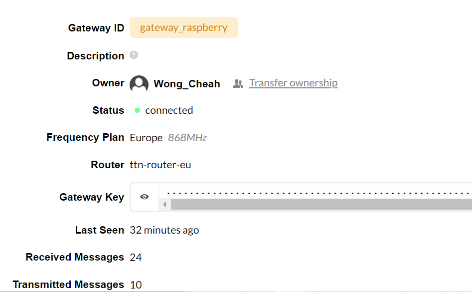

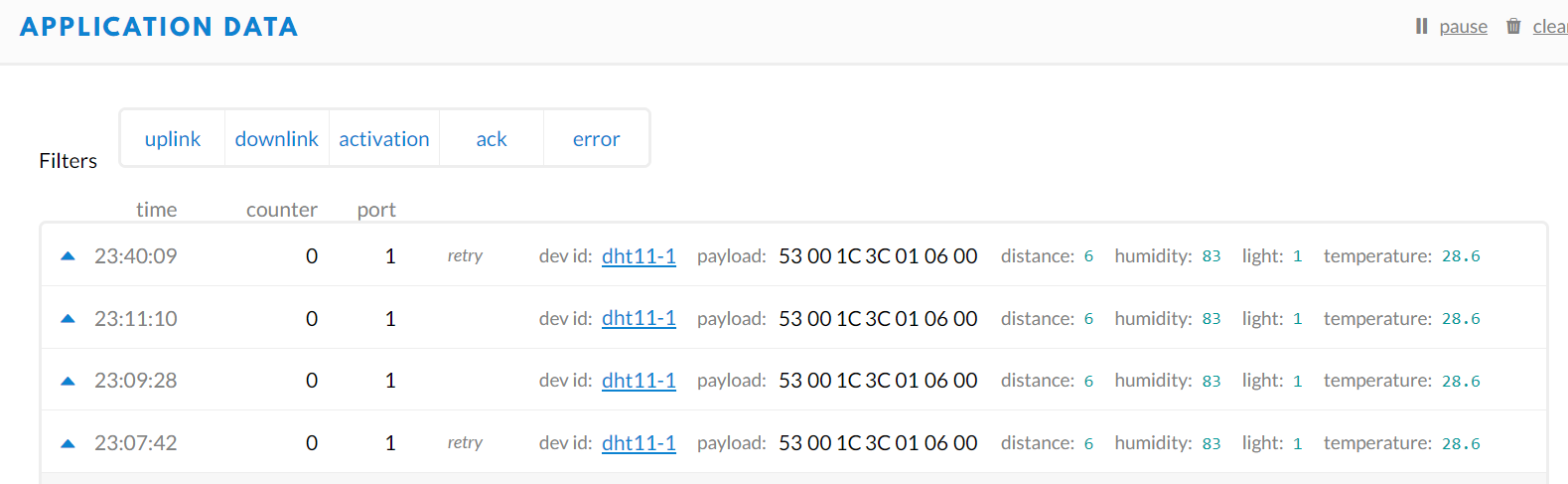

Hi, I’m new to TTN. I tried to create a LoRa Node ( Cytron LoRa-RFM Shield & CT-UNO) and setup LoRa gateway(Cytron Lora Gateway Raspberry Pi Hat 915Mhz HAT-LRGW-915). I follow this link to setup my gateway and it able to connect to TTN.
In one week before I succes to gather data from sensor device to TTN.
But today it suddenly cannot recieving anything new application data. When I recompiling the Arduino code, the status of device in TTN reactive. And receive once data shown in TTN application tab. In past I can receive repeated data and the counter will kept incresing.

Do any expert or senior know the reason cause this?
Your node firmware is defective if it keeps transmitting with a frame count of zero and not incrementing; this is not in compliance with the LoRaWAN specification, and it is not really going to work.

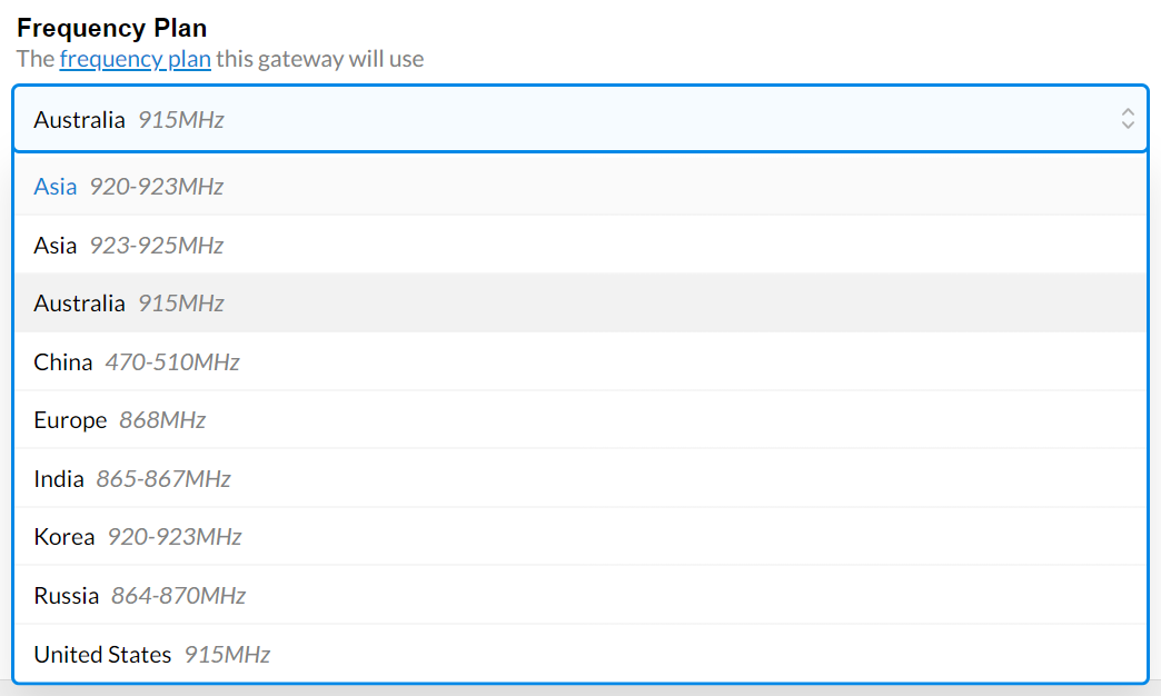

Also it was a mistake to buy 915 MHz components if you are going to operate on 868 MHz.

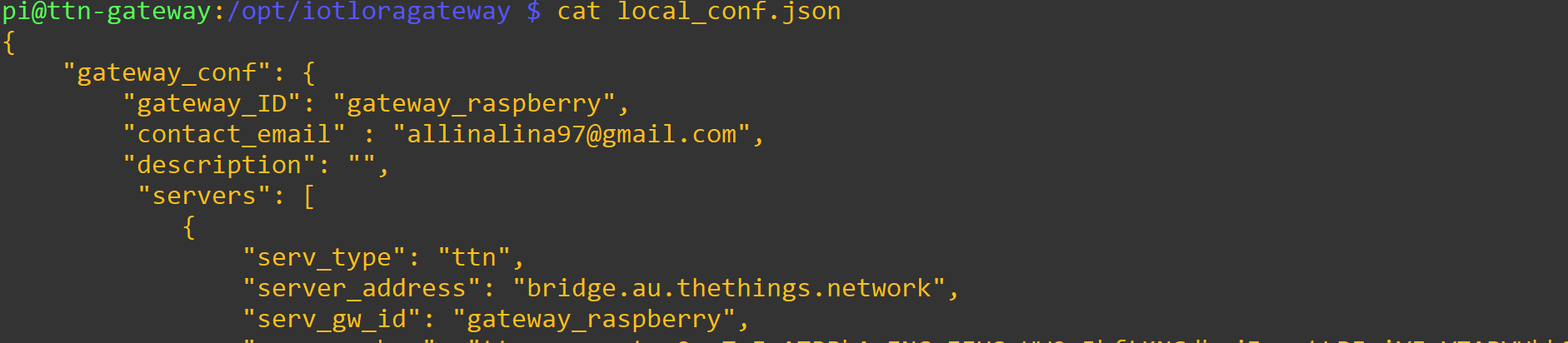

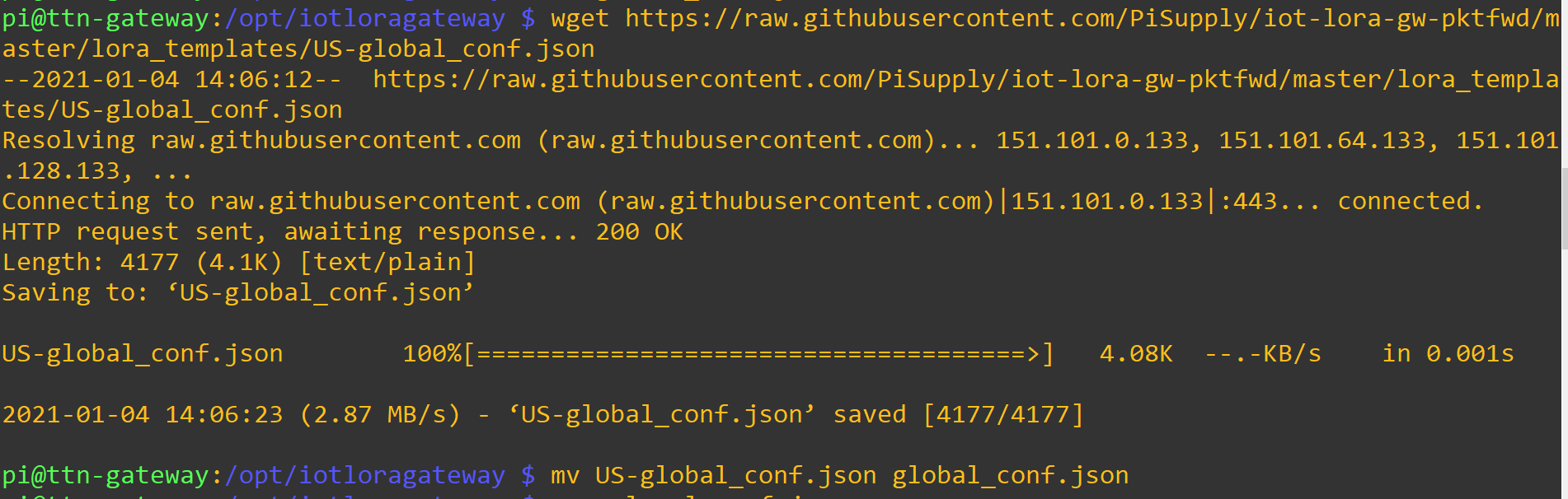

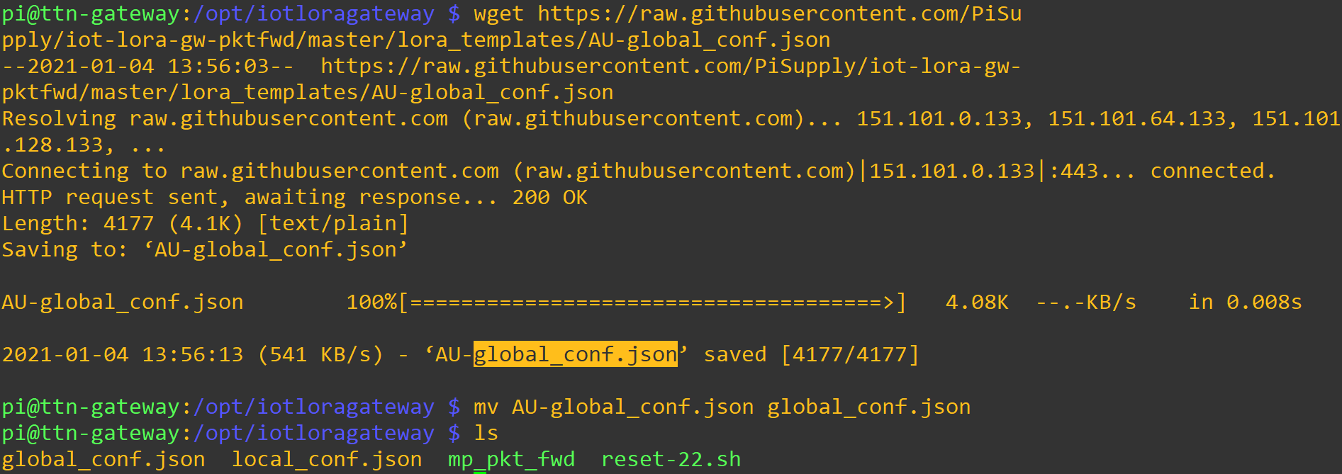

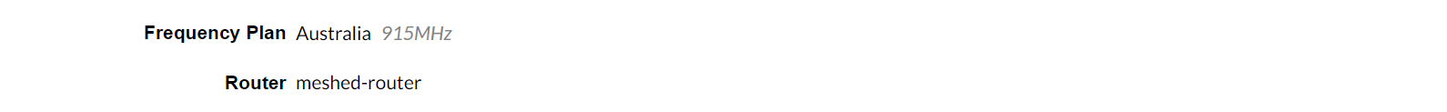

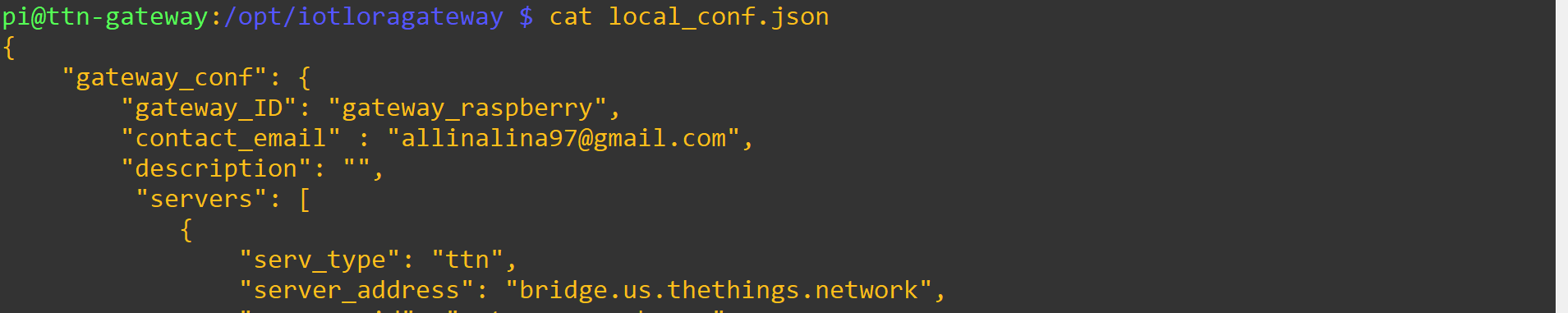

I change all to Australia with 915 MHz but failed to connect
13:59:14 *** Multi Protocol Packet Forwarder for Lora Gateway ***
Version: 3.0.20
13:59:14  *** Lora concentrator HAL library version info ***
Version: 5.0.1; Options: native;
13:59:14  INFO: Little endian host
13:59:14  INFO: found global configuration file /opt/iotloragateway/global_conf.json, parsing it
13:59:14  INFO: /opt/iotloragateway/global_conf.json does contain a JSON object named SX1301_conf, parsing SX1301 parameters
13:59:14  INFO: lorawan_public 1, clksrc 1
13:59:14  INFO: no configuration for LBT
13:59:14  INFO: antenna_gain 0 dBi
13:59:14  INFO: Configuring TX LUT with 16 indexes
13:59:14  INFO: radio 0 enabled (type SX1257), center frequency 917200000, RSSI offset -166.000000, tx enabled 1
13:59:14  INFO: radio 1 enabled (type SX1257), center frequency 917900000, RSSI offset -166.000000, tx enabled 0
13:59:14  INFO: Lora multi-SF channel 0>  radio 0, IF -400000 Hz, 125 kHz bw, SF 7 to 12
13:59:14  INFO: Lora multi-SF channel 1>  radio 0, IF -200000 Hz, 125 kHz bw, SF 7 to 12
13:59:14  INFO: Lora multi-SF channel 2>  radio 0, IF 0 Hz, 125 kHz bw, SF 7 to 12
13:59:14  INFO: Lora multi-SF channel 3>  radio 0, IF 200000 Hz, 125 kHz bw, SF 7 to 12
13:59:14  INFO: Lora multi-SF channel 4>  radio 1, IF -300000 Hz, 125 kHz bw, SF 7 to 12
13:59:14  INFO: Lora multi-SF channel 5>  radio 1, IF -100000 Hz, 125 kHz bw, SF 7 to 12
13:59:14  INFO: Lora multi-SF channel 6>  radio 1, IF 100000 Hz, 125 kHz bw, SF 7 to 12
13:59:14  INFO: Lora multi-SF channel 7>  radio 1, IF 300000 Hz, 125 kHz bw, SF 7 to 12
13:59:14  INFO: Lora std channel> radio 0, IF 300000 Hz, 500000 Hz bw, SF 8
13:59:14  INFO: FSK channel 8 disabled
13:59:14  INFO: /opt/iotloragateway/global_conf.json does contain a JSON object named gateway_conf, parsing gateway parameters
13:59:14  INFO: Found 1 servers in array.
13:59:14  INFO: Server 0 configured to "router.au.thethings.network"

13:59:14  INFO: gateway MAC address is configured to 0000000000000000
13:59:14  INFO: Server 0 configured to "bridge.au.thethings.network"

14:06:59  INFO: antenna_gain 0 dBi
14:06:59  INFO: Configuring TX LUT with 16 indexes
14:06:59  INFO: radio 0 enabled (type SX1257), center frequency 904300000, RSSI offset -166.000000, tx enabled 1
14:06:59  INFO: radio 1 enabled (type SX1257), center frequency 905000000, RSSI offset -166.000000, tx enabled 0
14:06:59  INFO: Lora multi-SF channel 0>  radio 0, IF -400000 Hz, 125 kHz bw, SF 7 to 12
14:06:59  INFO: Lora multi-SF channel 1>  radio 0, IF -200000 Hz, 125 kHz bw, SF 7 to 12
14:06:59  INFO: Lora multi-SF channel 2>  radio 0, IF 0 Hz, 125 kHz bw, SF 7 to 12
14:06:59  INFO: Lora multi-SF channel 3>  radio 0, IF 200000 Hz, 125 kHz bw, SF 7 to 12
14:06:59  INFO: Lora multi-SF channel 4>  radio 1, IF -300000 Hz, 125 kHz bw, SF 7 to 12
14:06:59  INFO: Lora multi-SF channel 5>  radio 1, IF -100000 Hz, 125 kHz bw, SF 7 to 12
14:06:59  INFO: Lora multi-SF channel 6>  radio 1, IF 100000 Hz, 125 kHz bw, SF 7 to 12
14:06:59  INFO: Lora multi-SF channel 7>  radio 1, IF 300000 Hz, 125 kHz bw, SF 7 to 12
14:06:59  INFO: Lora std channel> radio 0, IF 300000 Hz, 500000 Hz bw, SF 8
14:06:59  INFO: FSK channel 8 disabled
14:06:59  INFO: /opt/iotloragateway/global_conf.json does contain a JSON object named gateway_conf, parsing gateway parameters
14:06:59  INFO: Found 1 servers in array.
14:06:59  INFO: Server 0 configured to "router.us.thethings.network"

Then I tried United States915MHz still failed to connect
You can’t just go changing frequency plans like that!
First you determine what is legal for your location.
Then you source hardware built for that frequency range.
Then you configure it for the particular plan of using something within that range which TTN uses in your locality.
I stay in Malaysia. So I have to use frequency 919MHz to 923MHz right?
In this list, I better choose Asia 920-923 MHz and Korea 920-923MHz
915MHz LoRa Gateway Raspberry Pi Hat able to receive LoRa signals within frequency range from 900MHz to 930MHz (center frequency 915MHz).
RFM95W LoRa module operating in the 915 MHz frequency band
Is that mean I have to change my frequency plan to Asia 920-923 MHz or Korea 920-923MHz?
How about the ttn console router and LoRa Gateway Raspberry Pi Hat global and local json file?
pi@ttn-gateway:/opt/iotloragateway $ nc -v bridge.eu.thethings.network 1883
Connection to bridge.eu.thethings.network 1883 port [tcp/*] succeeded!
pi@ttn-gateway:/opt/iotloragateway $ nc -v bridge.as1.thethings.network 1883
nc: getaddrinfo for host "bridge.as1.thethings.network" port 1883: Name or service not known
pi@ttn-gateway:/opt/iotloragateway $ nc -v bridge.us.thethings.network 1883
nc: getaddrinfo for host "bridge.us.thethings.network" port 1883: Name or service not known
pi@ttn-gateway:/opt/iotloragateway $ nc -v bridge.kr.thethings.network 1883
nc: getaddrinfo for host "bridge.kr.thethings.network" port 1883: Name or service not known
pi@ttn-gateway:/opt/iotloragateway $ nc -v bridge.as2.thethings.network 1883
nc: getaddrinfo for host "bridge.as2.thethings.network" port 1883: Name or service not known
pi@ttn-gateway:/opt/iotloragateway $ nc -v bridge.au.thethings.network 1883
nc: getaddrinfo for host "bridge.au.thethings.network" port 1883: Name or service not known
pi@ttn-gateway:/opt/iotloragateway $ nc -v bridge.cn.thethings.network 1883
nc: getaddrinfo for host "bridge.cn.thethings.network" port 1883: Name or service not known
pi@ttn-gateway:/opt/iotloragateway $ nc -v bridge.in.thethings.network 1883
nc: getaddrinfo for host "bridge.in.thethings.network" port 1883: Name or service not known
pi@ttn-gateway:/opt/iotloragateway $ nc -v bridge.ru.thethings.network 1883
nc: getaddrinfo for host "bridge.ru.thethings.network" port 1883: Name or service not known
I tried this command and only bridge.eu.thethings.network connect successfully to port 1883
You cannot just base this on what is done in other countries in your region, first you need to determine what is actually legal in your country.
What you can reach on the Internet has essentially nothing to do with what frequency plan you need to be using
The port might be different on different clusters. You can try port 1882.
Sorry, I’m just new in this.
Cslorabox how to determine what is actually legal in my country? Which way can configure it for the particular plan of using something within that range which TTN uses in my locality?
After setting the frequency plan and router selected, my global(https://github.com/PiSupply/iot-lora-gw-pktfwd/tree/master/lora_templates) and local (“server_address”: “router.< region >.thethings.network”) json fie how should I update.

Ok thank you Kersing I will try it
