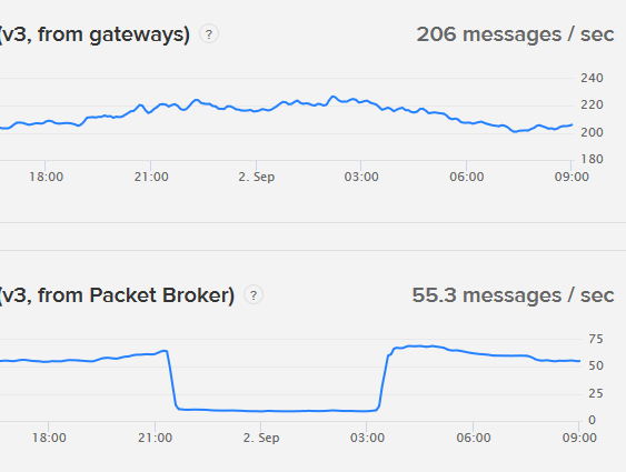

I was also wondering that nobody is complaining about this and the TTN status page give a status that everything is working smoothly, while the broker is down for such a long time:

I agree that there is no SLA, but why is the status page saying that “everything is operational” while a few inches lower on the page you can see that the packetbroker is down already many hours in forwarding v3 packets ?
It is run by TTN, so somebody must know that PB is is down in forwarding.
Maybe it is scheduled downtime, as far as I remember. was the duration in all 3 cases i noticed about 6 hours and there were still ~10 packets /sec forwarded. (while normally this is around 60 packets/sec

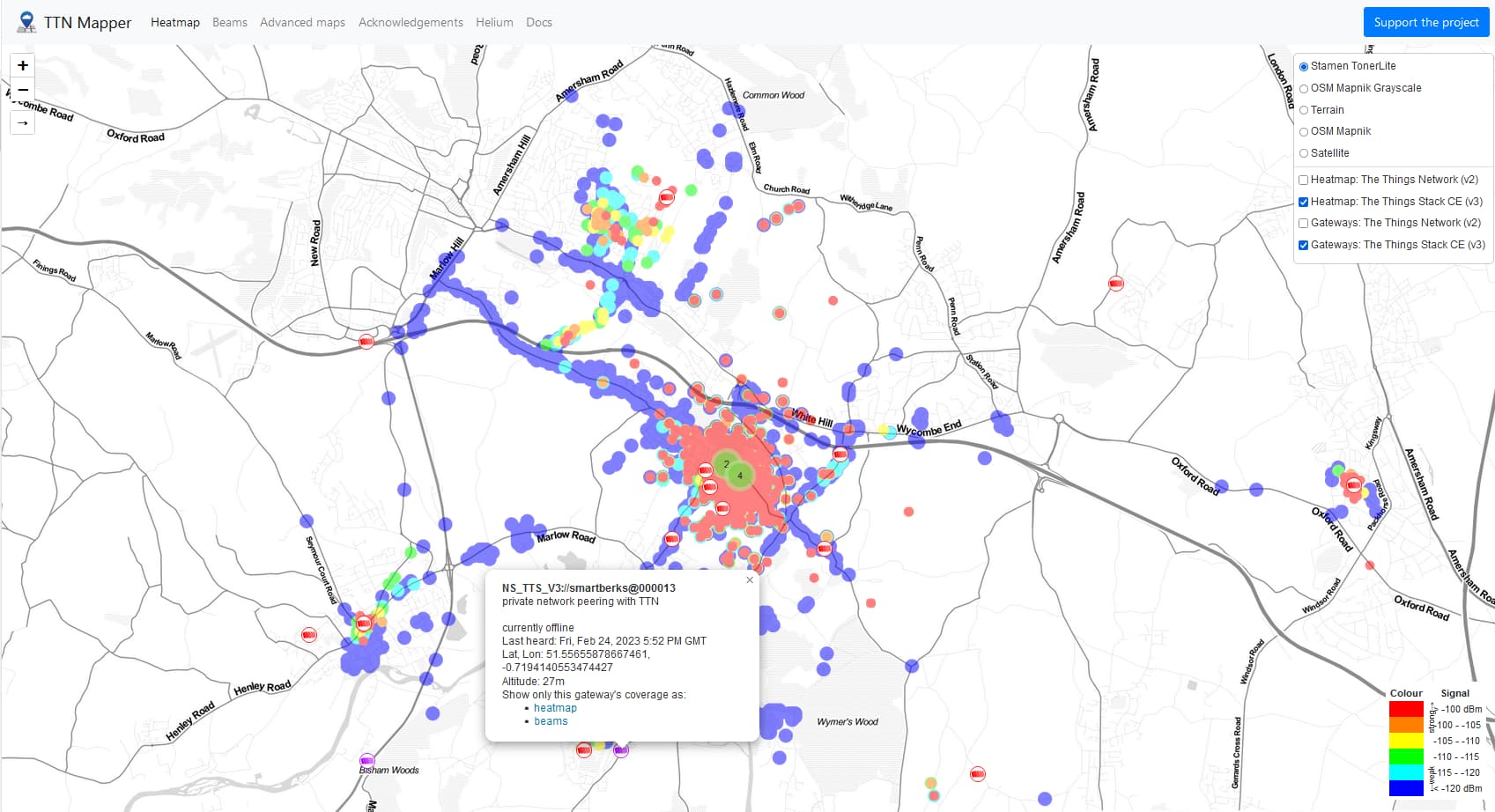

Around 5/6pm UKT this evening I happened to notice that TTNMapper - which I think shares some feeds and ultimately data with PacketBroker - was showing a significant number of GW’s in the area as offline, with last contact in that approx time scale. This evening @Johan_Scheepers contacted me to ask if seeing PB unresponsive - mapper.packetbroker.net. Checked a few GW ID for details and no response…

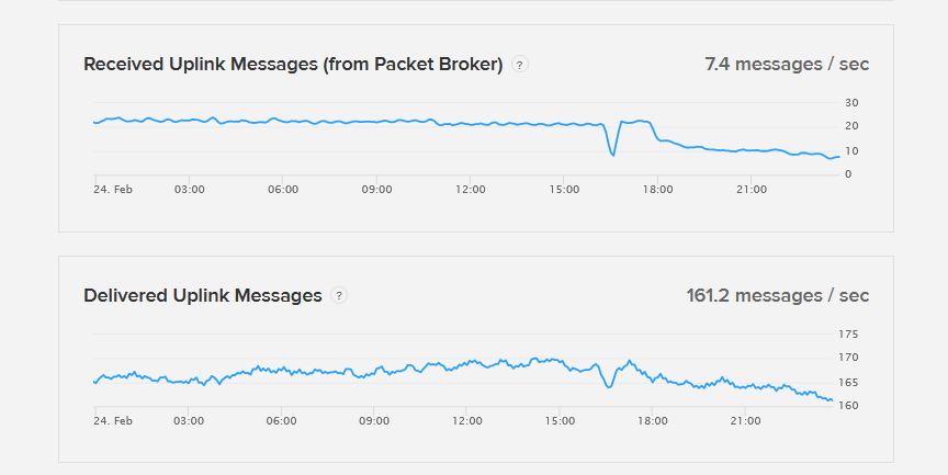

Have just checked status. https://status.thethings.network/
and can see that there has been a steady decline in traffic since then so clearly a problem
Anyone missing data or not seeing levels of traffic they expect then guess this most likely the reason. Hopefully someone from TTI Core will kick the servers shortly and all will be restored?! ![]()

However TTNMapper feeds seem still not to have recovered with Community GW’s (Red) still showing off line and Peering networks (through PacketBroker) (Purple) still showing offline and last seen in drop off window yesterday
Paging @jpmeijers !!! ![]()
Don’t quarry too hard @Johan_Scheepers
The TTN Mapper database server ran out of disk space. For now I increased the storage size, but that does mean I personally need to fork out more money to pay for this every month.
