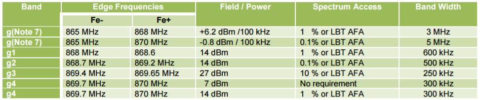

Class A nodes have two receive slots.
When the gateways uses slot 1, it sends in subband g1.
When a gateways uses slot 2, it sends in subband g3.
Slot 1 transmit power is 14 dbm
Slot 2 uses a preset frequency, normally 869.525 MHz -> transmit power 27 dbm
disclaimer: found this info with forum search - hope its correct :wink:
