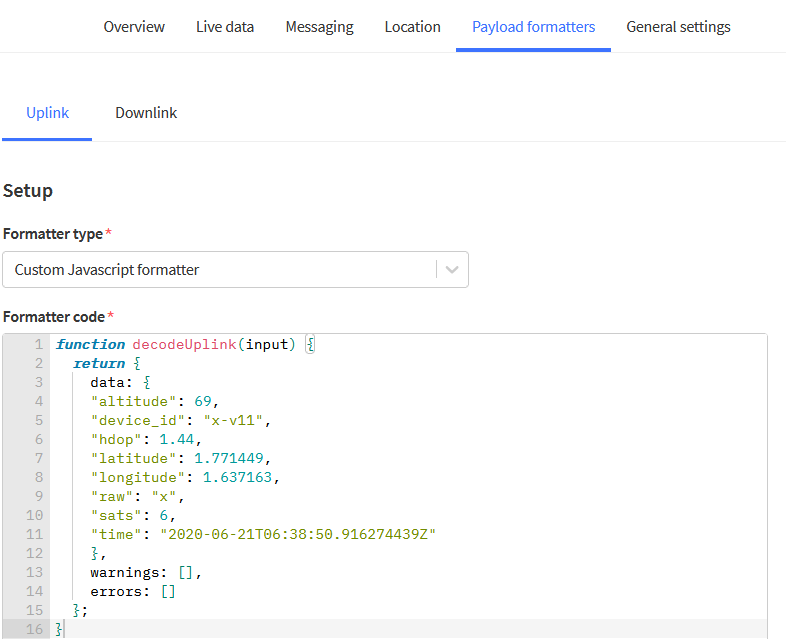

You need to have Latitude and Longitude information in the payload.

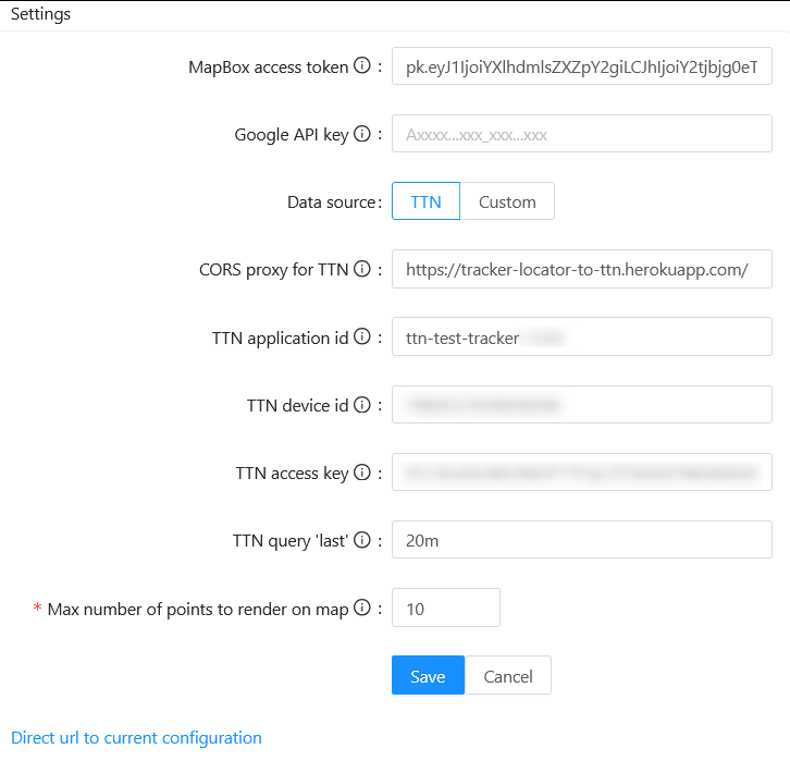

In “settings”, provide the relevant TTN application id, TTN device id and a TTN access token.
Best practice would be to create a dedicated access token for this use. The settings are stored locally in the browser. This app has no back-end of its own.
Adjust other optional properties in “settings”, save and reload data in the main screen.

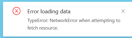

Very cool… I already export the data to my own mysql so looked at your ‘custom’ option where you add a URL, but I couldn’t find documentation on how to use this, i.e. what format for the custom url
Regarding the custom data source option, you can use any url. There is no specific format for the url. The format of the data needs to be the same as the format of the TTN Storage Integration, just a JSON array where each item of the array is the payload. Simple.

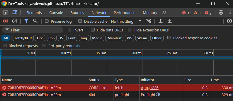

One last thing to note, you need to have cross origin access between the domain of the data source and the domain with the UI. If you are not familiar with CORS and CORS headers you might want to learn more about that, use a CORS proxy or ask me about your specific setup. In any case, use the “network” tab in the “developer tools” of the browser to troubleshoot data retrieval.

So, just the two lots of bad news for the public one on GitHub:
The CORS proxy that was setup isn’t running anymore - this takes the request from your browser and makes it look like it came from an authorised source due to the way that browsers & web servers work - it stops people freeloading off a web server when they are using another site - the request has to come from a browser that got the script from the original web server - but this can be bypassed with a proxy.
Despite being released at the time of v3, the public one is trying to use TTN v2.
I’ll figure out the logistics of uploading my version for Git hosting.
