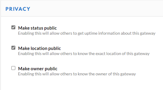

Gateway Privacy Settings
In V2:
capture 2021-01-28 15·33·47
In V3:
capture 2021-01-28 15·31·29
and
capture 2021-01-28 15·44·54
Questions
  • Why is ‘Gateway status Public’ default disabled in V3?
  • Why is ‘Publish location’ default disabled in V3?
  • Has option ‘Make owner public’ been removed?
    Is owner now private or public?
Status and location need to be public to make the gateway visible on maps so others can check if they are within range of network coverage.
Owner by default should be private.
For TTN community connected GW’s default should be status & location public, though I can understand that with e.g EU GDPR owner may now have to be opt-in vs opt out (but not neccessarily in other parts of the world?) - though sure should be there to opt in to as an enabler for community communication and info exchange and also to request help in debugging and checking coverage etc…
Also as a Community Initiator where I see new GW’s pop up in any of the Communities I have set up I often reach out to the owner and invite them to join the local TTN community, if not already a member, as part of the process - if I dont see who the owner is that initiative of Community building breaks! :slight_smile:
If status and location are not enabled by default, many (new) users will just not be aware or leave them disabled (‘just because’).
GDPR may play a role here but user is not clearly and explicitly informed about these choices. This will need to be improved in the console.
(Otherwise) we may end up with very empty gateway maps after the migration.

We should probably make this enabled by default for public networks, like The Things Network, indeed. I filed an issue: Make default for public gateway status, location and contact info configurable · Issue #3712 · TheThingsNetwork/lorawan-stack · GitHub
There’s really no such thing as an owner. This was already the case with V2, but that was a bit hacky. There are collaborators only, and those can be users or organizations.

Well, ‘Make owner public’ - owner is at least how this has been presented to users the last 4+ years.
The ‘owner’ was previously also displayed in gateway details on The Things Network Map (but not anymore lately).
What was (hacky) owner in V2 then?
Is it just me or is that contradictory (confusing at least) with the previous quote?

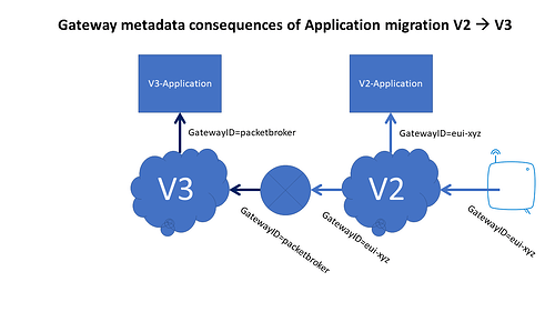

Per @pe1mew a visual representation of what has been described above and elsewhere:
