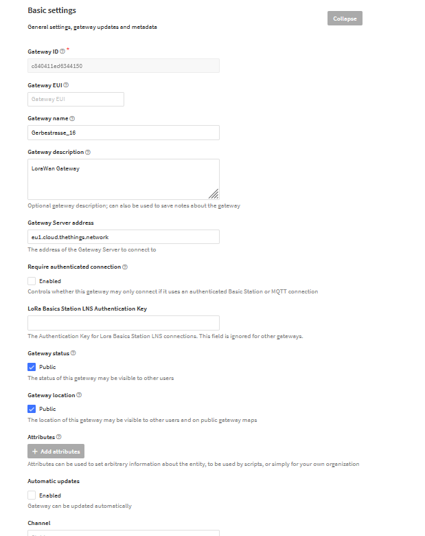

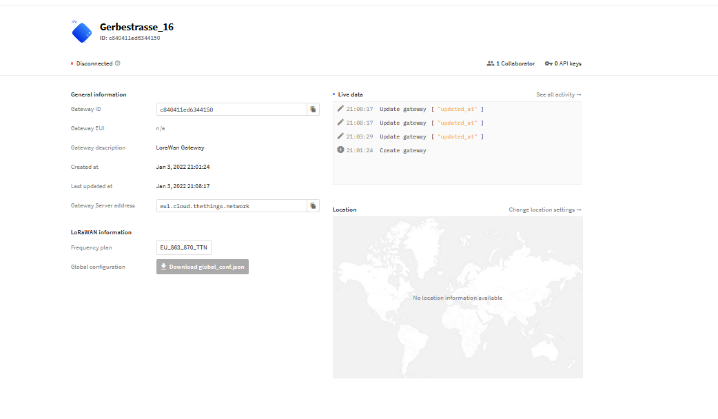

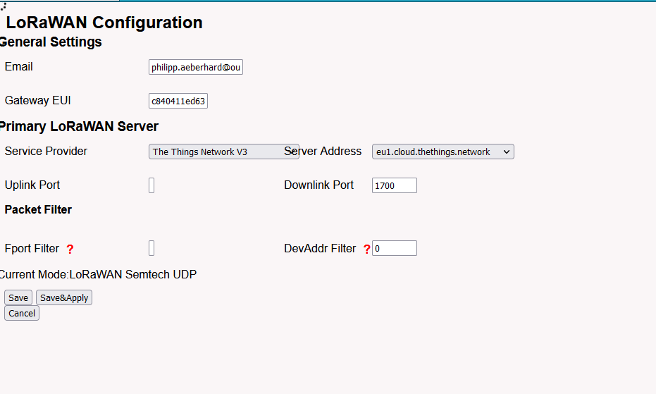

Hi all
Does someone see why the connection not work?
i did a update of the firmware, but it does not help.

The uplink port seems to be empty. It should be set to 1700.
Did you reset to defaults? That seems to be required for some firmware upgrades.
