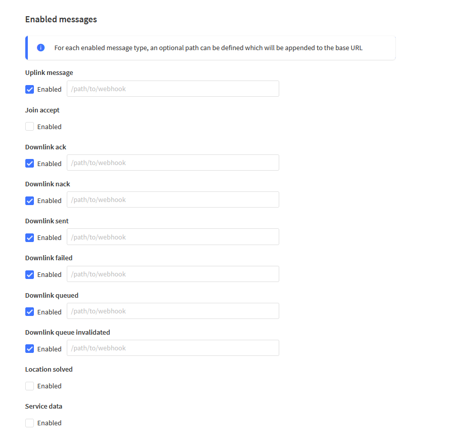

In the application settings → integrations → selected integration you can enable or disable these message. Perhaps you accidentally disabled some?
Capture
