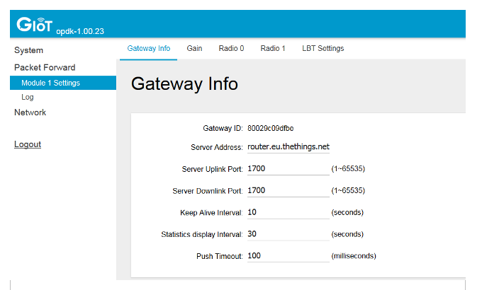

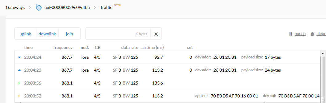

TTOG problems with sensors, configuration ok?
I just do not understand. Sometimes the sensor connects perfectly, then it does not work again. Even sensors that are restarted go once and then again no connection is made. Sensor is Xignal mousetrap. Gateway the TTOG. Maybe someone recognizes from the log data what could be. Thanks for your help.

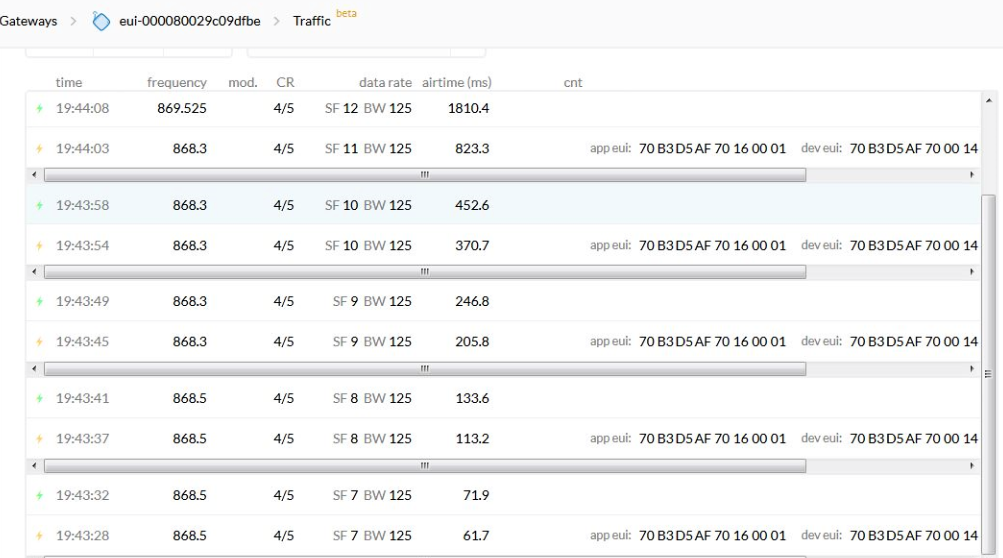

   => 00 00 80 92 E8 4A F4 BB 00 00 00 00 00 00 00 00 00
INFO: Beacon queued (count_us=3457774210, freq_hz=869525000, size=17):
INFO: tx_start_delay=1493 (1493.562500) - (1497, bw_delay=1.500000, notch_delay=1.937500)
INFO: Beacon dequeued (count_us=3073774715)
JSON up: {"rxpk":[{"tmst":3071682812,"time":"2019-11-02T18:44:13.908216Z","tmms":1256755453908,"chan":5,"rfch":1,"freq":868.100000,"stat":1,"modu":"LORA","datr":"SF12BW125","codr":"4/5","lsnr":10.2,"lsnr_min":7.8,"lsnr_max":13.0,"rssi":-40,"size":23,"data
":"AAEAFnCv1bNwPRQAcK/Vs3AZY6nibyE="}]}
INFO: Received pkt from mote: 70160001 (fcnt=46037)
JSON up: {"rxpk":[{"tmst":3061535372,"time":"2019-11-02T18:44:03.760772Z","tmms":1256755443760,"chan":6,"rfch":1,"freq":868.300000,"stat":1,"modu":"LORA","datr":"SF11BW125","codr":"4/5","lsnr":9.5,"lsnr_min":7.0,"lsnr_max":14.8,"rssi":-40,"size":23,"data"
:"AAEAFnCv1bNwPRQAcK/Vs3DODVkO3yI="}]}
JSON up: {"rxpk":[{"tmst":3052115180,"time":"2019-11-02T18:43:54.340579Z","tmms":1256755434340,"chan":6,"rfch":1,"freq":868.300000,"stat":1,"modu":"LORA","datr":"SF10BW125","codr":"4/5","lsnr":9.8,"lsnr_min":6.8,"lsnr_max":16.0,"rssi":-49,"size":23,"data"
:"AAEAFnCv1bNwPRQAcK/Vs3D/b6zFbXQ="}]}
INFO: [up] PUSH_ACK received in 86 ms

JSON up: {"rxpk":[{"tmst":3043500908,"time":"2019-11-02T18:43:45.726303Z","tmms":1256755425726,"chan":6,"rfch":1,"freq":868.300000,"stat":1,"modu":"LORA","datr":"SF9BW125","codr":"4/5","lsnr":12.2,"lsnr_min":9.8,"lsnr_max":14.8,"rssi":-44,"size":23,"data"
:"AAEAFnCv1bNwPRQAcK/Vs3ChFV6A2i8="}]}
JSON up: {"rxpk":[{"tmst":3034958884,"time":"2019-11-02T18:43:37.184276Z","tmms":1256755417184,"chan":7,"rfch":1,"freq":868.500000,"stat":1,"modu":"LORA","datr":"SF8BW125","codr":"4/5","lsnr":10.8,"lsnr_min":8.5,"lsnr_max":13.2,"rssi":-47,"size":23,"data"
:"AAEAFnCv1bNwPRQAcK/Vs3C8fgVXl58="}]}
INFO: [up] PUSH_ACK received in 69 ms
JSON up: {"rxpk":[{"tmst":3026457804,"time":"2019-11-02T18:43:28.683195Z","tmms":1256755408683,"chan":7,"rfch":1,"freq":868.500000,"stat":1,"modu":"LORA","datr":"SF7BW125","codr":"4/5","lsnr":9.5,"lsnr_min":7.0,"lsnr_max":12.8,"rssi":-48,"size":23,"data":
"AAEAFnCv1bNwPRQAcK/Vs3CHfhuDkos="}]}

grafik
After restarting the gateway, it works again.
