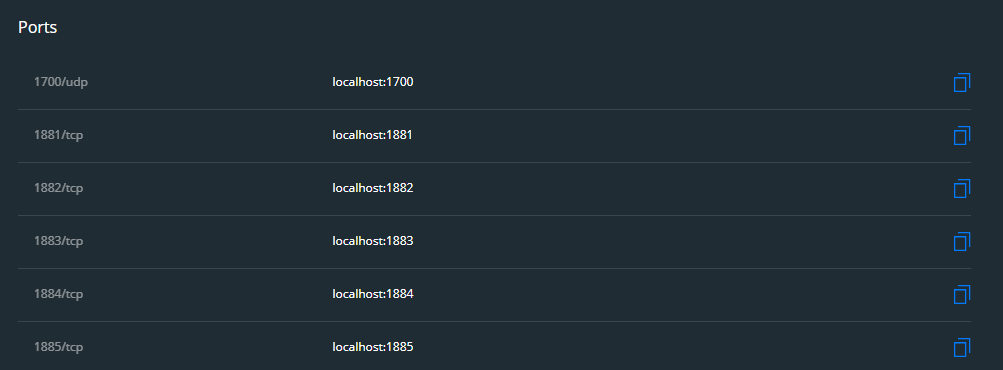

What i noticed after a few hours of digging is that there are 2 processes running on port 1883. One is the Docker application so that one is the mqtt integration, the other one is from mosquitto. So this makes me believe that for some reason the mosquitto client can’t connect to the mqtt server because this one is running in docker?

Docker will expose the ports of the application running within a container, I don’t think docker itself uses port 1883
As far as I can tell Docker doesn’t change the port.

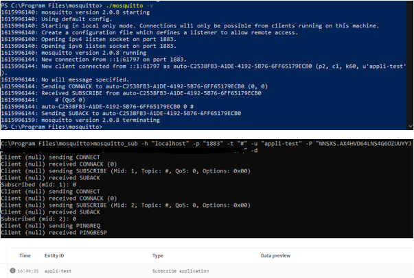

But this got me thinking and trying something new. I made a mosquitto broker run using cmd. When the broker was running I subscribed using the mosquitto_sub mentioned in the top post. Then I stopped the self launched mosquitto broker.
This somehow caused the mosquitto_sub to subscribe to the TTS mqtt integration?
I am happy that it connects but I am so confused as to why/how it connects suddenly.

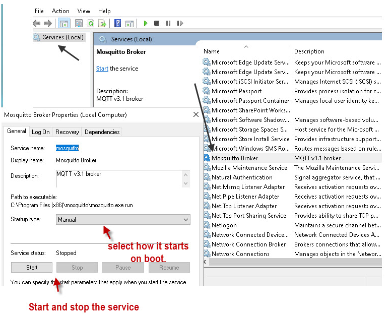

As to why it is working suddenly. While I was trying multiple things I also did this: image
Then after I did this I manually started and stopped the broker. And Because i changed it to manual it did actually stop. And that could be why my mosquitto_sub suddenly subscribed to the TTS mqtt integration? It would also explain why it wouldn’t work before (since it would keep connecting to the mosquitto broker which was automatically running?)
I am not sure but this seems to be the most plausible explanation?
