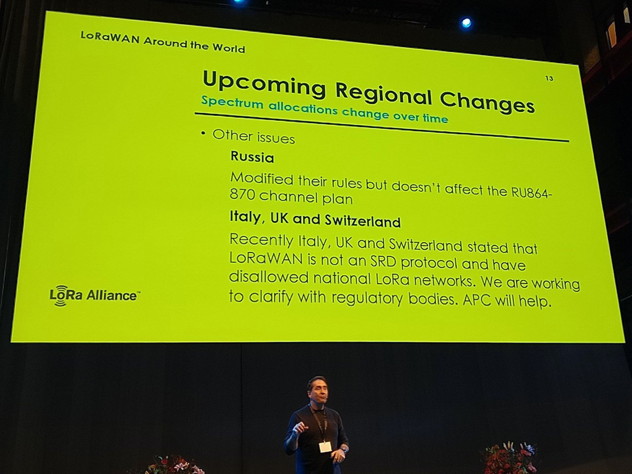

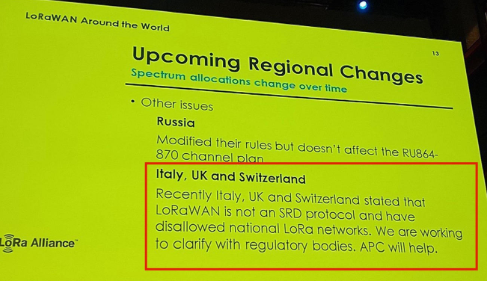

This:
Is worrying!
Recently Italy, UK and Switzerland stated that LoRaWAN is not an SRD protocol and have disallowed national LoRa networks. We are working to clarify with regulatory bodies. APC will help.
What constitutes a national network? How does that impact mine /others efforts building out regional networks. If I stop one town short of national is that ok? :rofl:…but seriously…if using ttn/tti as underpinning is that then national… Who is not allowed, me, others, ttn? :thinking: typical gov dumb think imho :wink:
These days ‘dumb think(ing)’ from the UK government is a daily occurance.
@mark-stanley what have your buddies @ digital catapult had to say/contribute on this? I gather Alex @ the ttn-Conf… May be worth having a chat with him?
Hi Jeff,
I can’t speak for the Catapult.
I’d like to see a reference to where Ofcom said this, because I haven’t been able to find it. My immediate feeling is of disbelief.
  1. I don’t understand the relationship between not being SRD and so not being allowed nationwide.
  2. If true I’d be wondering how IoT Scotland (a public sector funded national LoRaWAN) network got approved?!
  3. I’d also wonder if this applied to other LPWAN - Sigfox, NB-IoT etc., and if not, what makes LoRa special?
    I suspect the slide is missing some context.
Cheers, Mark
I’ll try to check with some old L-A & Ofcom contact in coming days…perhaps you could do the same & we come back here or the recently opened TTN UK Communities & Gateways Thread to update all?
I wasn’t as Conf so unsure whose pitch it was…perhaps we can get them to own the statement & follow up…just saw slide posted in the Conf Paparaze thread & thought WTF!! :wink:
Agreed, I’ll look into it and reply here. It was the lora alliance presentation so you’d think it was credible. Just sounds /feels wrong

Hi @Jeff-UK, thanks for this but I think that this is completely fake news. The organisation that I work for is participating in Ofcom workshops on “Supporting the expanding role of wireless innovation in UK industry”. As part of the documentation for this, Ofcom is actively promoting “Low Power Wide Area Technologies” and lists Sigfox, LoRa and NB-IoT. Sigfox and LoRa are both listed as operating in the “868 MHz licence exempt band.” The use of LoRa is also actively promoted in other recent Ofcom documents such as the Connected Nations 2018 UK report.
As a bit of Sunday morning entertainment I trawled through all the ERC and ETSI documents that are relevant to SRD. These are legalistic documents filled with formal definitions but nowhere is “short range” defined in terms of distance, it is only referred to in terms of RF power and the capability to interfere with other radio systems.
It seems very unlikely to me that the UK’s Ofcom is about to attack Sigfox or LoRa.
danger
Can anybody elaborate on this?
Will Lora now soon be forbidden in Italy, UK and Switzerland?
What about the Swisscom LoRa net, covering (nearly) the whole country?
What is the origin of this statement? Originated from Lora Alliance? Fakenews?
Germany?
Appreciate that is the case and currently plodding on with deployments! :wink: I do worry that there may be some assumptions here and also fake news via LoRa-Alliance would not be confidence building so am prepared to believe there is something behind this on basis of ‘no smoke without fire’.
Also whilst we are all happily deploying on local/community/regional level there is another aspect to the statement - "disallowed national LoRa networks’ (is that short range vs national the issue?!) - what does that mean for my plans for world (sorry, strike that) domestic domination or the roll of TTN/TTI as a national infrastructure provider (…silently strokes his fluffy white cat…)
you really think LoRa-Alliance would spread ‘fake’ news ?
This is politics imho… like with Brexit, UK citizens can’t own .EU domains… things like that, the EU must punish the UK , must ‘hurt’ them … they act like children imho
No I dont - unless by accident! This was ref to Tim’s @cultsdotelecomatgmai comment earlier in thread calling this (fake news) out as possibility.
Also this is supposed to be a UK (Ofcom?) decision - so I cant blame on Eu this time :slight_smile: Poss self inflicted wounds!
We do need L-A to ‘own’ their statement, however…don’t know who’s pitch it was as just an uncaptioned picture from teh Conf Paparaze thread. Do you know? Can you ding them or one of the TTN guys to follow up and explain…clearly a cause of concern & potential stress…
I will try … its of course important :sunglasses:
@Wienke @johan @htdvisser
gentleman … please shed some light on this slide
kromhouthal-241
NOT TRUE !
For reference this is the original photo link https://twitter.com/Bahnhofsoma/status/1091323711888736257
There are more from the same talk on that twitter.
This is the LoRaWAN Regional Parameters Standardization talk by David Smith, CTO of MultiTech and Co-chair LoRa Alliance regional parameters working group
