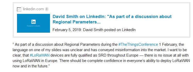

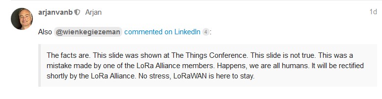

This is not enough for you ?? hmmmm
this is not a clarification bĂ˝ LoRa Alliance
No stress, LoRaWAN is here to stay
@bluesensing1 chairs and representatives of the LoRa Alliance commented on LinkedIn. This fuzz is not worth a press release. LoRaWAN works and is allowed in Europe and there are a lot of great deployments ahead, both public and private.

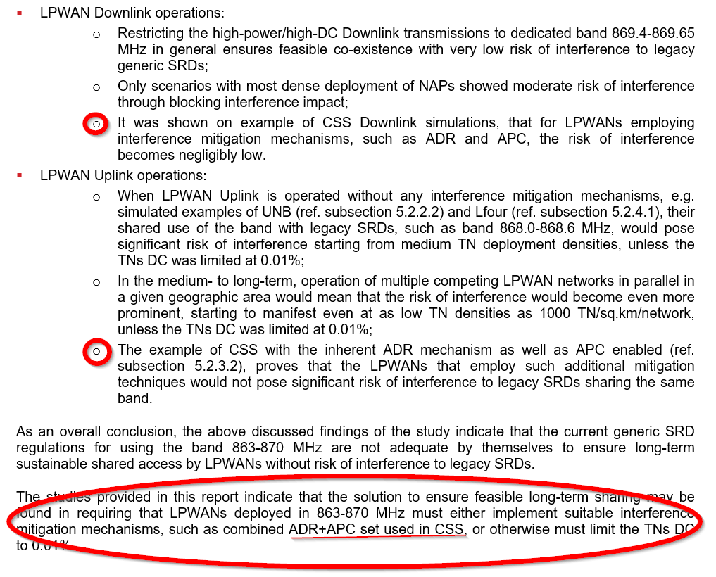

More on the concern of LPWAN in UK and Italy
https://www.cept.org/Documents/se-24/48179/se24-18-069_iot-lpwan-vs-legacy-srd-study-wi69
Very interesting reading nestor. Thanks.
It seems that, according this study, CCS (LoRaWAN) has a negligible impact in SRD when using SDR+APC
