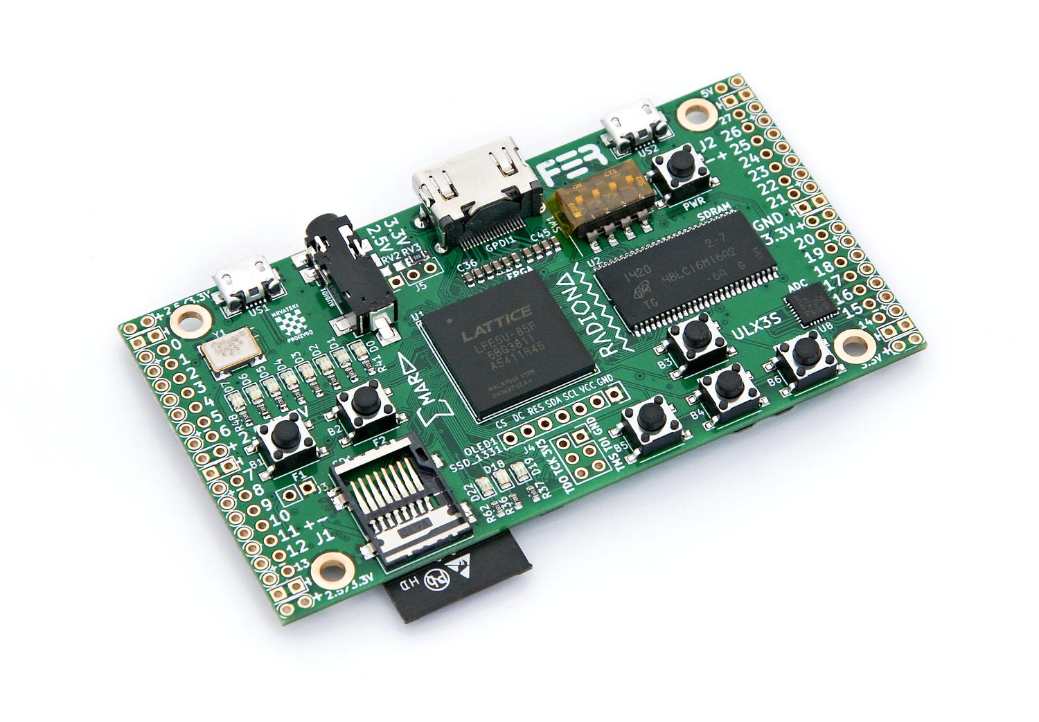

Tnx to radiona.org member Marvin we got our first message out of ULX3S FPGA
FPGA_LoRa_TTN
FPGA_ULX3S_LoRaWAN
Did you connect an sx1276 to the board, or are you doing modulation on the FPGA? In the latter case, did you reverse engineer lora and make your own implementation?
Tnx for asking. This is only SPI comunication with sx1276. So no reversing on this case.
