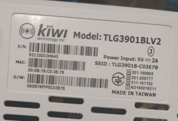

when i replace id=‘…’ with id = 000B78FFFEC03E78
i get a response saying: message “store: not found: get gateway”

{"netID":"000013","tenantID":"ttn","id":"eui-000b78fffec03e78","eui":"000B78FFFEC03E78","clusterID":"eu1.cloud.thethings.network","updatedAt":"2022-09-24T13:49:45.730255Z","online":false}

This is actually correct way, there is a deferens between your gateway EUI and gateway ID.
https://mapper.packetbroker.net/api/v2/gateways/netID=000013,tenantID=ttn,id=eui-000b78fffec03e78

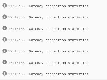

Do you see live data?

the only part of live data I am able to see is as attached in the image below:

But you need to get a sensor/node up, best way to tell if things are working.
