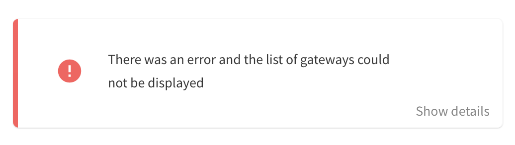

Dear sir,
When I clicked Gateways from the top manual bar, I cannot see the list of gateways (The Things Network Console). There is a message showing “There was an error and the list of gateways could not be displayed” (as shown below).

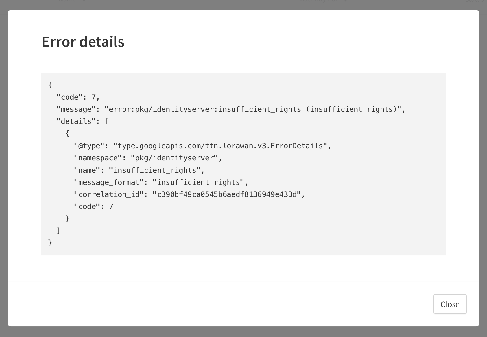

Under “Show details”, there is json showing:
  "code": 7,
  "message": "error:pkg/identityserver:insufficient_rights (insufficient rights)",
  "details": [
      "namespace": "pkg/identityserver",
      "name": "insufficient_rights",
      "message_format": "insufficient rights",
      "correlation_id": "c390bf49ca0545b6aedf8136949e433d",
      "code": 7
May I know what do I need to do to see gateway list?

We’re you previously able to view the list of gateways using the same account?
Are the gateways yours? Does anyone else have access to the gateways (and inadvertently modified your permissions)?
I am having the same issue on nam1 this morning, 11/26 11am EST. I am the owner of 4 gateways. No one else has permission to alter permissions. They were visible 11/24. Same error as above, except
"correlation_id": "d274f5bbc2704db1b134ae453baa423e"
