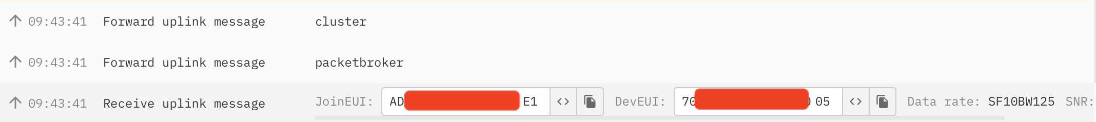

For the gateway I am receiving the uplink message it then forwards it:
Forward uplink message cluster
Forward uplink message packet broker
For the end node I am then getting an error message that says:
“data”: {
“namespace”: “pkg/networkserver”,
“name”: “uplink_channel_not_found”,
“message_format”: “uplink channel not found”,
I was able to connect and uplink data, but now I am having issues. Any advice is appreciated! Thank you in advance!

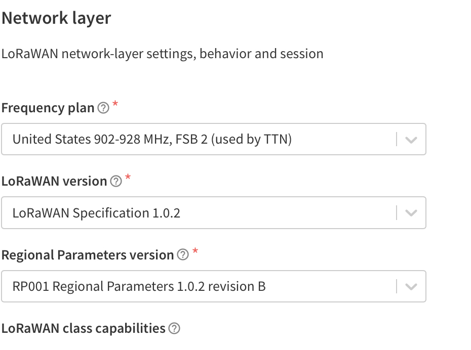

The error is listed on the same line. It mentions the uplink frequency is not found for your device. This usually means the device in the TTN console was added with a frequency plan that doesn’t match the device firmware.
However due to the information you do not provide in your question we can only guess.

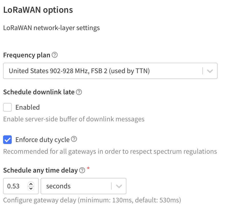

Hi @kersing This is what I have for the gateway:
9BC81B72-F399-4984-AD36-BC257E449F5C
and this is what I have for the end node:
957A0B60-2C34-4B4F-8A26-CBC3AFD2ADF4

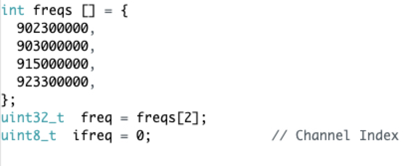

To connect to the TTN I am using Arduino Esp32_LoRaWAN library and example code for the OTAA connection.
6FB4EB8C-069B-4E92-A1AB-BA3853755DF6
A0B43CF3-F46F-43D6-95E8-329915F327CB

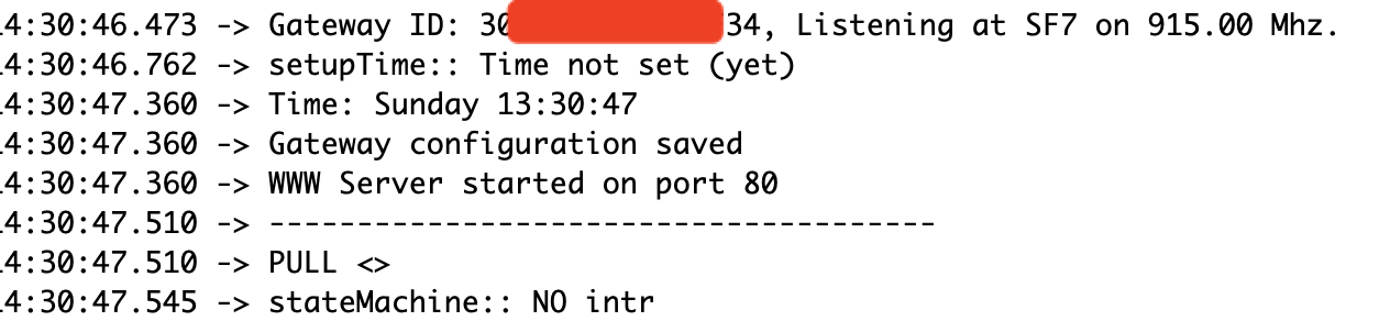

Hi @descartes yes, Ill provide the information:
I have an Esp32-single-channel gateway from GitHub - vpcola/ESP32SingleChannelGateway: A Fork of the popular ESP8266 single channel gateway adapted to ESP32 on the 915Mhz band.
I am in the US region and my device is the Heltec LoRa WiFi v2 868-915Mhz and I am connecting via OTAA. I ensured that my AppEUI, DevEUI, and AppKey are all correct.
Thanks again for your help!
Please search the Forum. Single (or Dual) Channel GW’s are not supported on TTN and have been depricated then unsupported for many years. You are seeing one of the consequences of using such SCPF’s. They are disruptive to other users…please disconnect it from TTN ASAP.
Get a full LoRaWAN (8+channels) GW and try again…they are not expensive.
