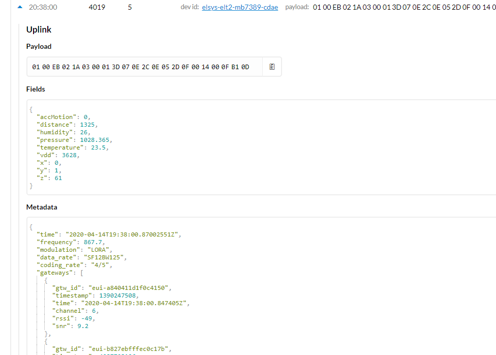

We have a device (from Elsys) working and transmitting data periodically. It is being received by a number of gateways, but we are seeing duplicate metadata when we inspect the individual packets … and moreover whilst the gateway ID is the same, some of the actual metadata is different … does anyone know what is going on?
If I look at an individual received packet in the TTN Console … e.g. Applications -> elsys-elt2-mb7389-ttn -> Data
I’ll see …
Clicking on the up-triangle there lets me see the detailed data and meta-data, and the latter shows me which gateways received the packet.
You don’t need to read this, but it looks like this …
Here is the actual metadata, hopefully legible this time …

The gateways eui-b827ebfffe5852a9 and eui-b827ebfffe45866e appear twice …
First instance …
"gtw_id": "eui-b827ebfffe5852a9",
"timestamp": 4167918644,
"time": "2020-04-14T19:38:00.85149Z",
"channel": 5,
"rssi": -89,
"snr": -15.2,
"latitude": 51.45731,
"longitude": -0.2191,
"altitude": 30
Second instance …
"channel": 6,
"rssi": -46,
"snr": 10.2,
"altitude": 30
So, same gtw_id and timestamp, but different values for channel, rssi and snr.
Likewise:
"gtw_id": "eui-b827ebfffe45866e",
"timestamp": 3541415508,
"time": "2020-04-14T19:38:00.873465Z",
"channel": 6,
"rssi": -59,
"snr": 9.5
and:
"timestamp": 3541415532,
"channel": 5,
"rssi": -90,
"snr": -8.8
Again the same gtw_id and different values for channel, rssi and snr, and also different timestamps.
