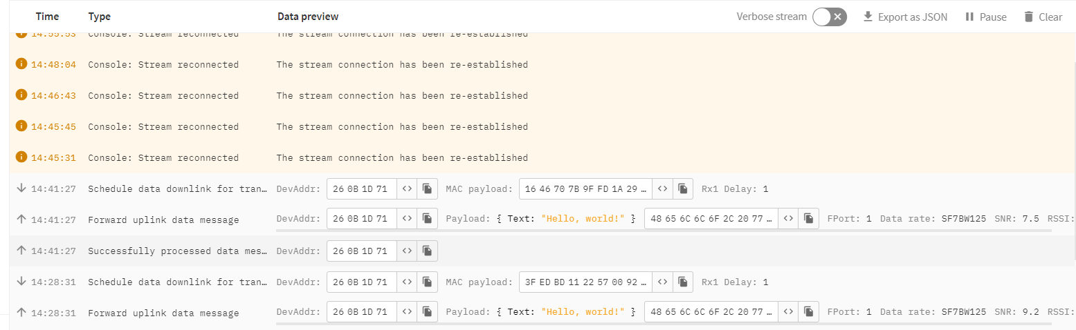

My arduino was sending data , once i unpluged it and repluged to power i can’t receive data from it until i create a new application and new device , i am new to this field who could help me please and if there guide or a tutorial link

What is the RSSI of your node? Needs to be -65 or greater, other wise you might experience problems.
Hello RSSI between -13 … -16
Separate your node and gateway, 10m 0r more and a brick wall in between - RSSI need to be -55 → -65 or lower.
To solve your issue you need to switch from ABP to OTAA mode.
