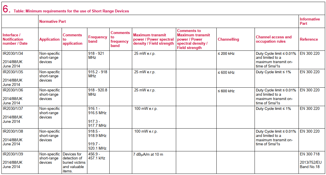

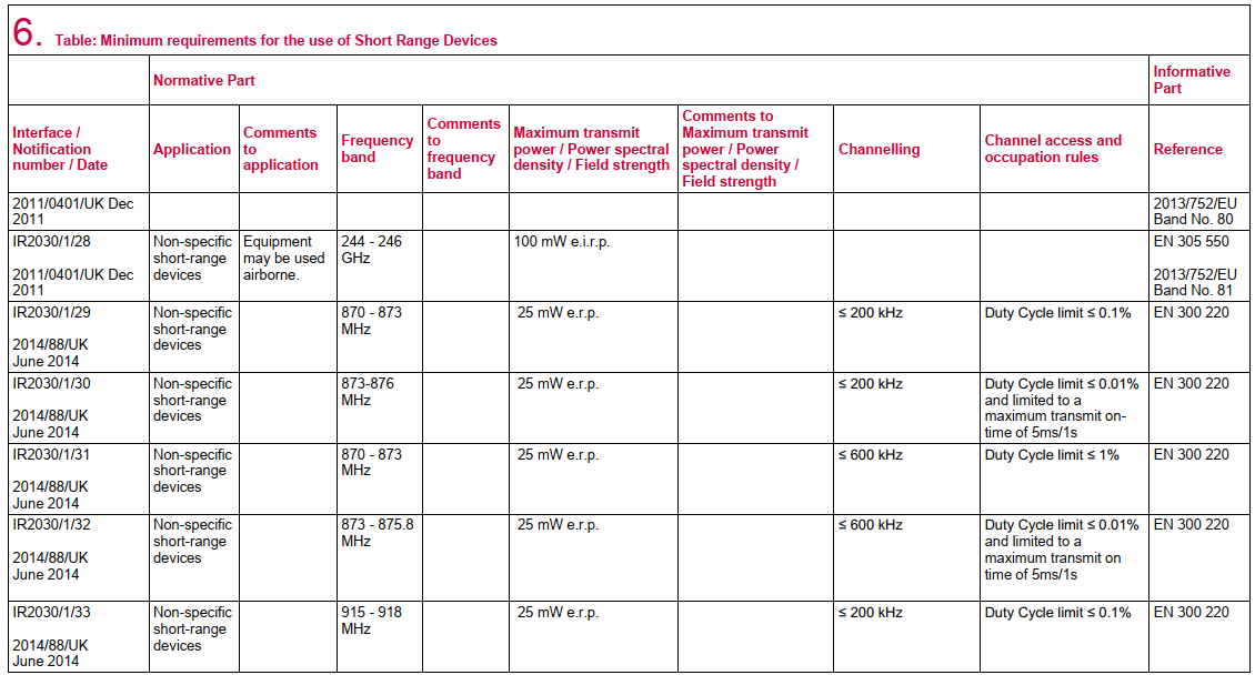

Currently IR2020 shows this;
Screenshot - 14_04_2022 , 12_12_50
Screenshot - 14_04_2022 , 12_13_12
There is a band between 915Mhz and 918Mhz that allows for 1% duty cycle.
