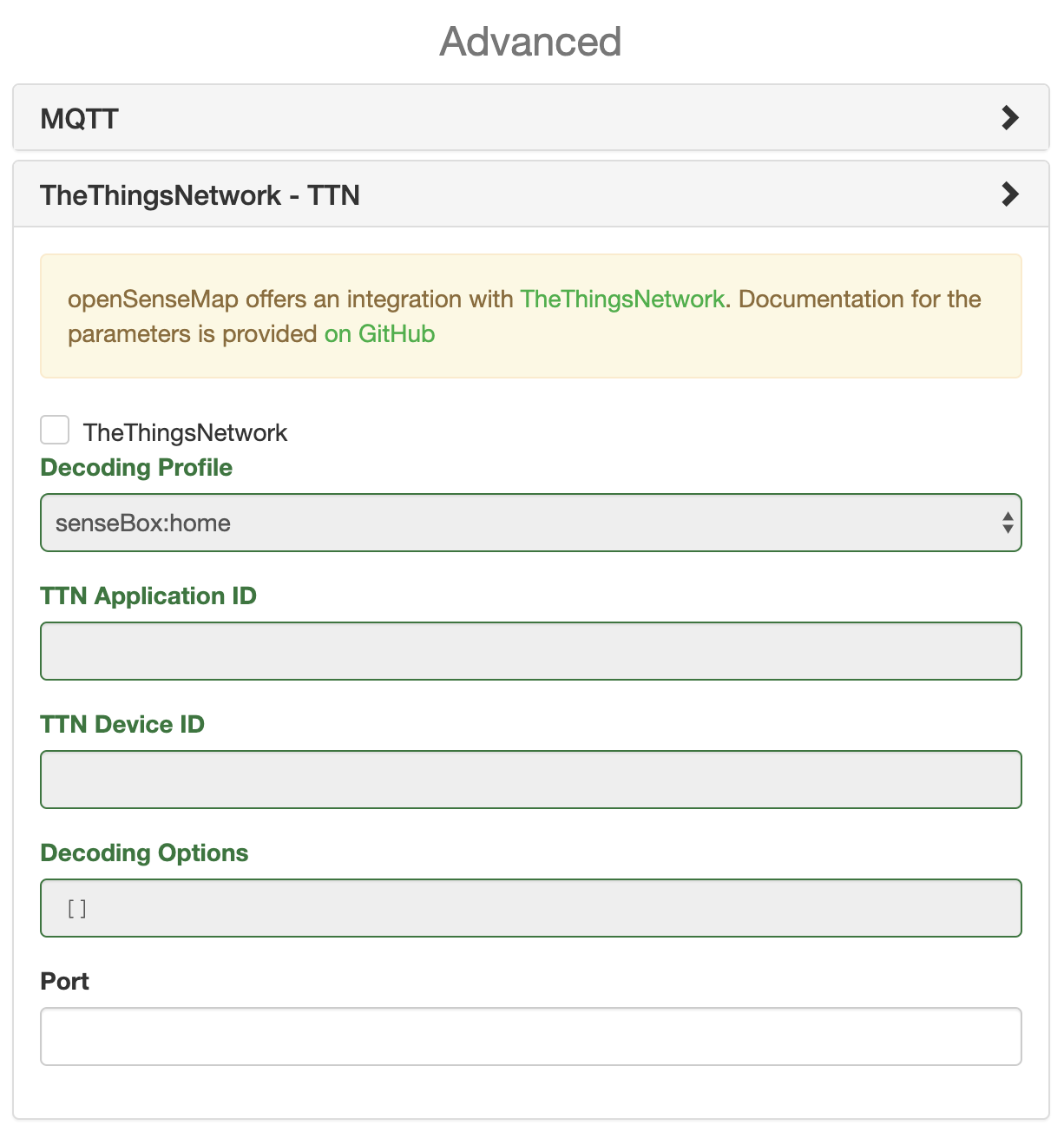

Reading the ttn-osem-integration README I thought one had to deploy that microservice on one’s own server. But: no, it’s actually already available for anyone:
openSenseMap TTN
One could also use MQTT directly, without the HTTP Integration:
openSenseMap MQTT
The above screenshot seems to be missing inputs for the username and password, but those need to be encoded into the connection options; see also the TTN MQTT documentation for the required details.
