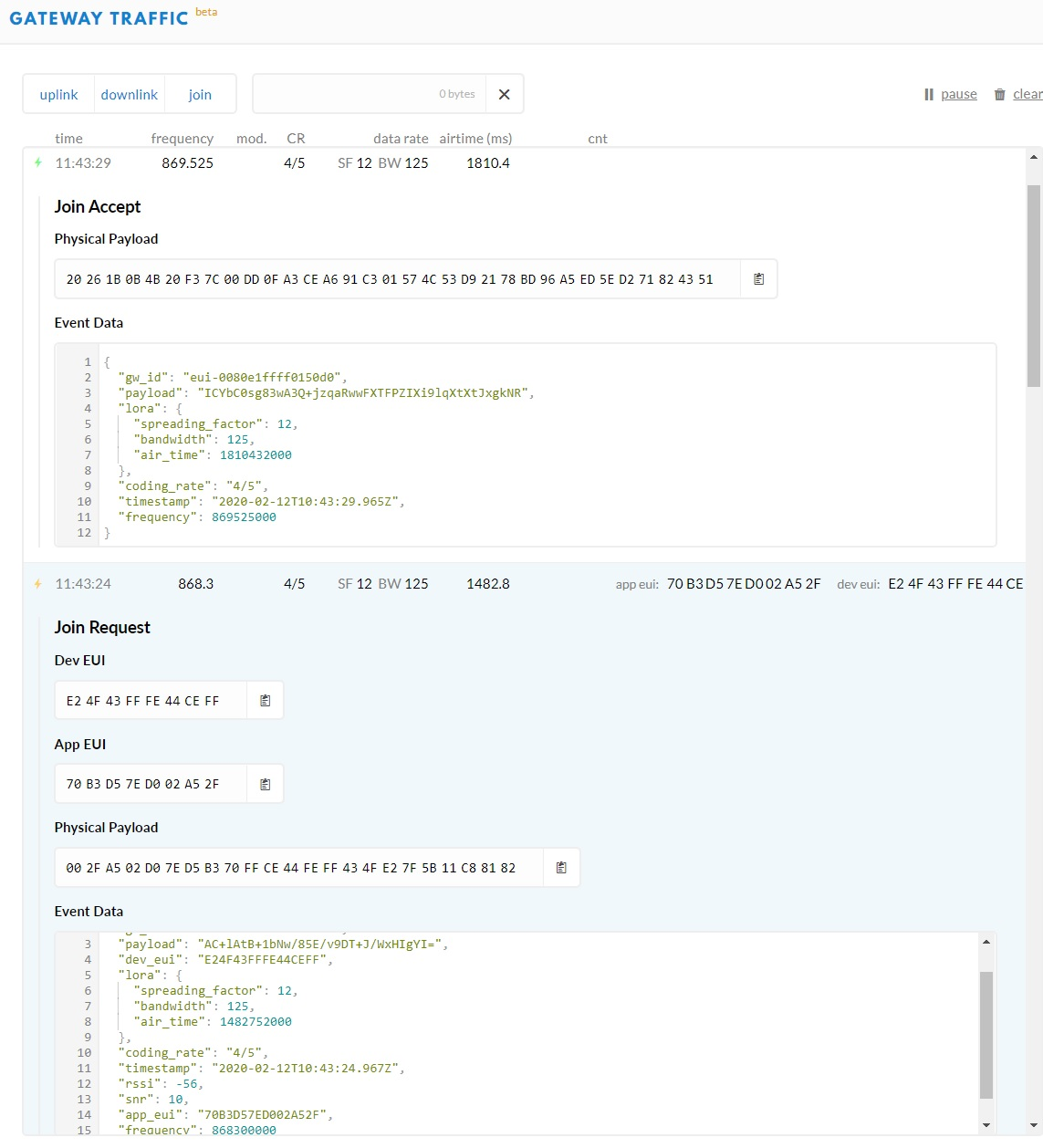

Hello,
I run the at_master example from I-NUCLEO-LRWAN2 eval pack.
I did update the firmaware to set my app id and app key using LoRa_SetAppID() and LoRa_SetKey().
It worked correctly. I’m collecting data through TTN.
Then I did reboot the device and from that point, the app is no more functionnal.
Using gateway logs from TTN. I can see that after a join request, the gateway sent a “Join Accept” frame. (see screenshot)
If I sniff the serial port for AT commands, I can see that the modem answers “OK” to the “at+join=1” but does not send the “+JoinAccepted” as I think it should. See logs below:

9.496428500000000 <— # <<-------- No answer to join.
9.496515499999999 <— ’ ’
29.503772000000001 <— ‘0’ <<-------- Start New attempt

That was yesterday. This morning, I reflashed the gateway firmware, plugged the node and… it works. I reboot the node et have the same issue than yesterday. I re-reflashed the gateway without anymore success.
Do you have any idea of what may happen?
Thanks
Julien
