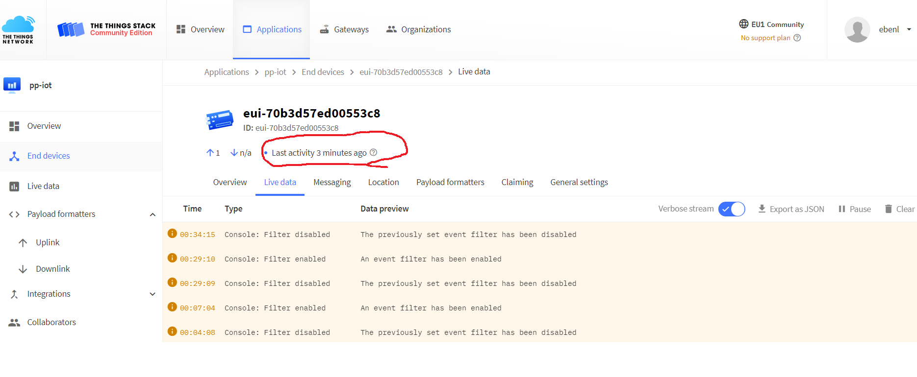

Hello, I’m sending data to my GW, I can see the activity counter change in TTN, but the LIVE DATA never shows anything?
As per many other posts asking similar, this is not updated in absolute real time due to the constraints / load on the servers …
Thanks Nick
The thing is that I never see any “live data”. I understand that it can’t be realtime, just strange that nothing ever shows.
Erm, apologies, you’d circled the thing most people ask about - if you mean you never get an entries in the log underneath, then there is something preventing the device from matching EUI’s etc at the Network Server level so it can’t pass it on to the application console.
How are you joining, what is the device, the stack, it’s version and can you check the EUI’s / keys.

Hi Nick, I see live data now showing in the console :grinning:
Did you perhaps change anything? Awesome to see the data!
