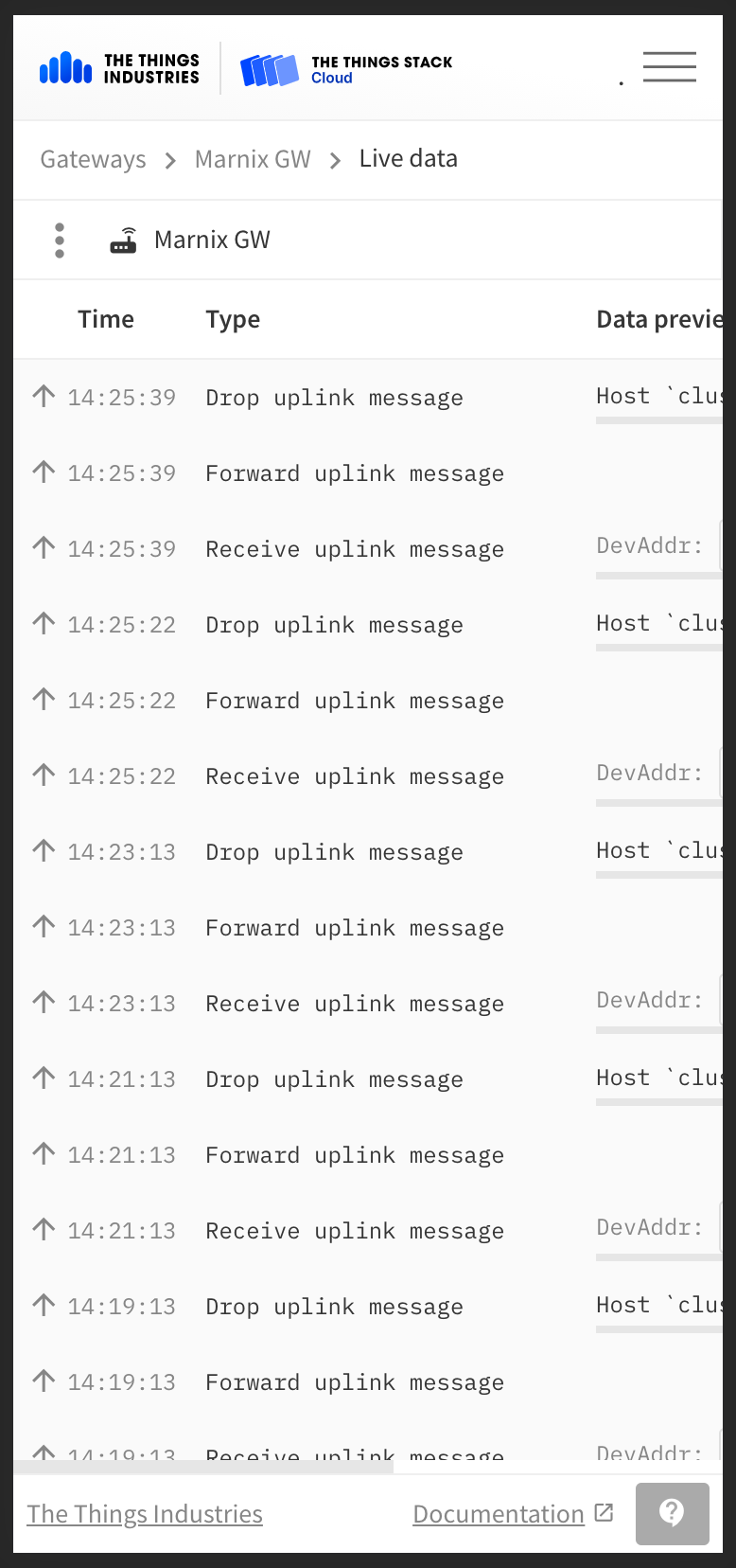

I see. Yeah indeed you’re always free to come up with your own interface that suits your specific needs (which is part of the power of TTS). Obviously though in the Console we try to come up with a design that suits as many needs as possible. As is known, we’re not quite there yet, but improvements will come in steadily now.
Btw, regarding mobile, the TTS Console is fully responsive and also the event views are optimized for mobile screensizes (obviously with some limitations). We will flesh this out further with the ability to hide columns as well, but it can already be used pretty smoothly (imho).
